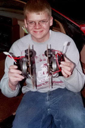

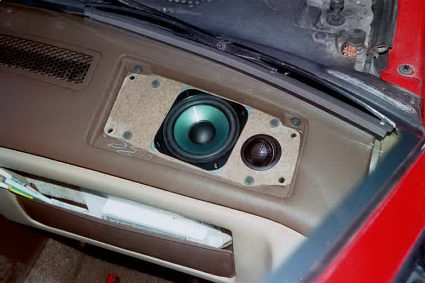

Well this is a work in progress but I thought that I would post what I have done so far. The front speakers have been in for over a month now. Daniel (NOCONES) came over one day and made my adapter plates while I tried to screw things in the engine compartment.
Here he is showing off his handy work.

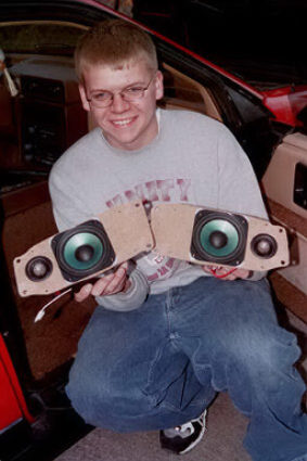

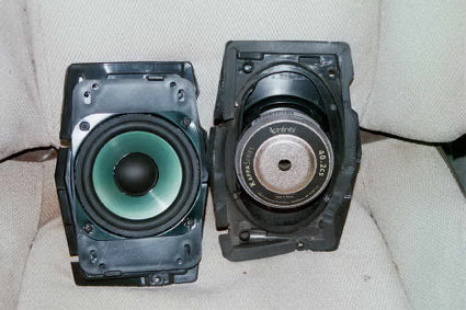

Notice in this next picture that crossover is mounted to the bottom to make it all one unit.
And this is how they look installed.
If any of you have noticed that your speaker covers sit slightly lower than your dash, I fixed this problem by making my adapter plate go all the way out to where the speaker grill mounts. Now mine sit just slightly higher than the dash and I think this looks much better.

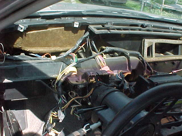

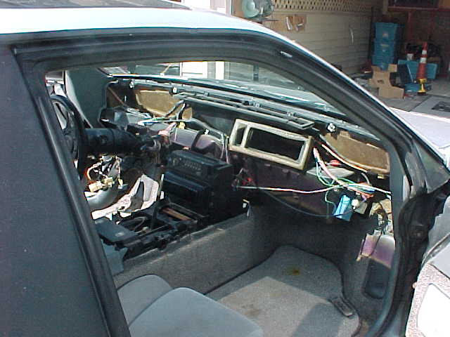

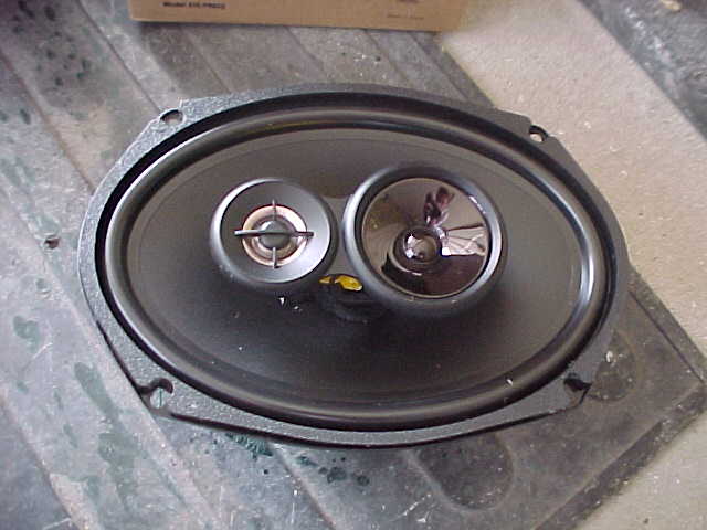

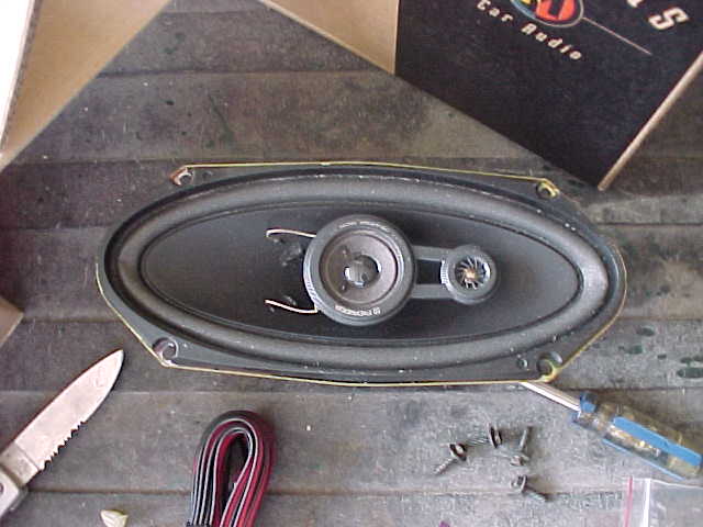

Why the itty-bitty speakers? Check out my pics of my 6x9 install in the dash.
-dash is out
-original kenwood 4x10
-new memphis audio 6x9
-all back together, can't even tell it was out
-all back together and clean, ready for the car show later on that night
Ewwwwwww.... Oval speakers. No offense I just don't like oval speakers. They are just physically unable to recreate accurate sound.
I know mine are a little small but I didn't want to cut the dash to put larger ones in. I have a few good ideas for subwoofers though.
