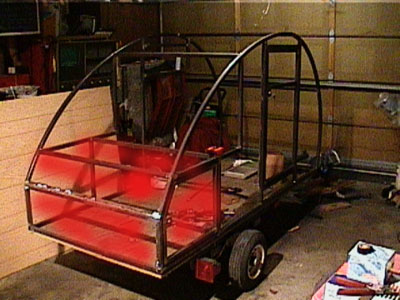

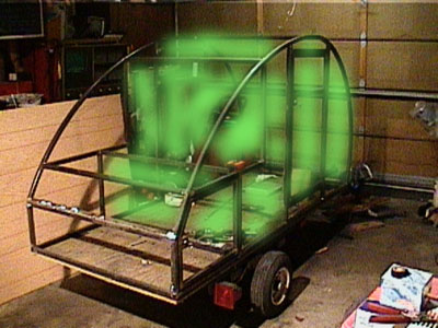

I know some may not think this is a big deal, but. I am tired of sleeping in a tent on my overnight trips to South Dakota. I took it to the Mile High Fieros of Colorado get-together today. 80MPH on the interstate isn't too bad. Now to find out how it tows after it is enclosed. It will come in handy for the Dells run (any way those are the plans at this time). Here is the start of my camper-sleeper. It will be 7'6" by 3'6" with the sleeping compartment 5'10" (I'm 5'7") by 3'4" inside and 4' high at it's highest point. It will have a storage compartment in the rear large enough to hold my 110 volt generator, 5 gal gas can, and my tool box. Outside covering is still to be determined.
Dnyee's 88 Formula, Casey's 86GT, Wayne's 86GT.
We consider my wife as being "Fiero Challenged"

Cool cool, should be pretty funny, how big are you? are you sure your gonna fit comfortably in there?

Looks a little drafty.

I think it was back in the 50's they had mini trailers like that. I saw one recently, I thought it was kinda cute.

I teased him about that at our club meeting today.......it looks like an old Airstream trailer.
Once it's done it will look nice......all that's done right now is the bare frame and it actually looks better in person than in the photos.
I can't wait until it's done!

got any pictures of your hitch? With the axle that far back, it should tow ok, provided it never starts whipping; it's gonna catch some wind from oncomming big trucks..

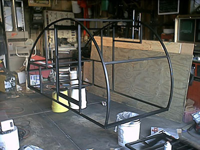

they call them taerdrop trailers, i have a lot of links in my favorites on them. I've always wanted to build one but never had the time. they really aren't bad to sleep in. good luck lets see it when its done.

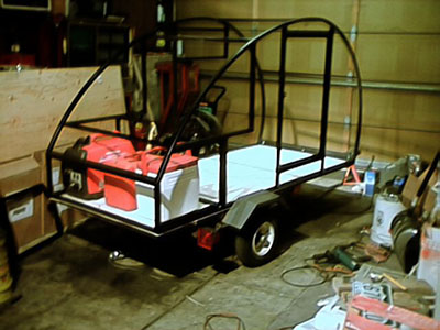

Looks great, but you might want to consider moving your storage up to the front. Generators and tool boxes can weigh alot, and from the looks of the rest of the trailer you might end up with negative tounge weight (that's bad) If you put the storage in the front it should be beter (that's good). Now if your planing on having the bed oover the storage, just make the storage full length, with the generator up front tool box in the middle and camping suplies filling in around them (that's best )
As for the weight distribution, I started out with a 4’x4’ trailer. I added almost 4’ to it. Of that 3’ is out front with 1’ to the rear. After I get all done if there isn’t enough weight on the tong, I’ll add a box to hold the gas can up front.
you should use tin or some other form or sheet metal give it some wieght.
Plan was to cover the outside with a sheet of paneling facing in and then covering that with a sheet of white rough plastic (the kind you see in public bathrooms). If you look at some motor homes, the doors are covered with this material. At the meeting today one of the members said he works at a metal fabricating place and can get sheets of almost anything. We talked about covering the top with aluminum. The ideas are only limited by $$$$.

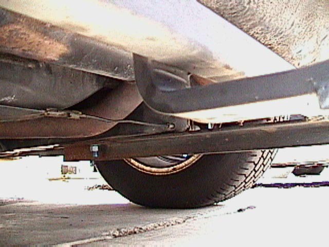

Here is a picture of the hitch.
Here is how it is bolted on (you can see the 1 bolt on each side referenced in the picture above).
And the trailer before I started this project (with me standing on the hitch).
Are these two bolts the only thing holding the hitch to the car? I don't think that would be all, but that's all I could see in the pictures. If that is all....you have a design change in mind? I sure wouldn't trust those two bolts to hold all that force, especially with the weight and leverage you're giving it.
Just practicing being a nerd, hope I'm not spoiling any fun.

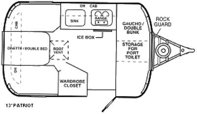

I know building your trailer is a lot of fun but....,
You might want to rethink the generator thing. Gen sets that provide clean, regulated 110 vac are very heavy, very expensive and usually have to be refilled with gas after a relatively short period of time.
12 vdc battery is a lot less useful but a lot lighter and more reliable. Most appliances can be found that use the dc power.
Also, I don't think the Fiero is "rated" to tow any weight so I don't think anyone has a real idea of what weights can reliably be towed.
Your intro lists 3 items that together will weigh 200 lbs. Verify what the trailer dry weight is and add carefully. 10 to 15 percent of the weight must be on the tongue/hitch for stability. Also, make sure your axle is rated to carry the weight you are adding.
For kicks, this little gem dry weight is 950 lbs. [url] http://www.casitatraveltrailers.com/show.html[/url]. I wonder how it would tow/look behind a Fiero?
At this time, yes. I have a plan designed to attach it farther back on the frame also.

here is the one i want to build

Hey Chuck,
The Casita 13' is a great little self-contained trailer.
I saw one successfully pulled by a 4 banger Honda.
It is BELOW the rated tow weight (dry, I realize).
It could be fun to try one!

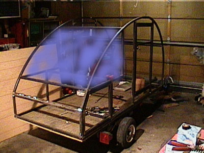

where did you get the hitch/reciever assembly from?
It started out as a hitch for a Chev Corsica. I just added 2x2 angle iron to bolt it to the lower cradel. I used grade 5 bolts. I can stand on it as in the picture above and it won't give. Mr Fiero pointed out that with the load I'm now going to pull it should be attached back by the rear cradel for safety and backup.
Notice the opening area on the rear of the bike trailor above
My original design had a trunk almost identical to that trunk idea. I changed for reasons of possible leakage. I don't plan on holding parties in it so I only need a sleeping area.
Below are some crude pictures but they will give you an idea of the layout. I would take it outside for a side shot, but it is cold and snowy here.
red is cargo
blue is storage for inside stuff
green is the sleeping area

Report this Post03-05-2002 09:56 AM Click Here to See the Profile for wkaylSend a Private Message to wkaylDirect Link to This Post
YEA, all the welding is done and the cage is painted. Now to remount everything back on the trailer and start covering the outside.
CoolBlue87GT
Posts: 8536
Total ratings: 150
Report this Post03-05-2002 10:18 AM Click Here to See the Profile for CoolBlue87GTSend a Private Message to CoolBlue87GTDirect Link to This Post
Very neat Idea. Wish you good luck.
hugh
Posts: 5563
From: Clementon,NJ,USA
Total ratings: 160
Report this Post03-05-2002 07:14 PM Click Here to See the Profile for hughSend a Private Message to hughDirect Link to This Post
I suggest you use grade 8 bolts and self locking nuts when it comes time to do the final mounting of the hitch.

Report this Post03-05-2002 11:35 PM Click Here to See the Profile for stimpySend a Private Message to stimpyDirect Link to This Post
No galley? Usually that blue area holds a sink, propane stove, and icebox. My folks used to have an old teardrop when I was a kid. I would love to have one.

Report this Post03-05-2002 11:55 PM Click Here to See the Profile for wkaylSend a Private Message to wkaylDirect Link to This Post
I am using the hardened bolts now on the hitch. I also am going to use them to bolt the frame of the camper to the trailer.
I did some more work tonight. I got the flooring material glued to the floor and everything bolted back on the frame. Next I will enclose the "trunk" and after that start to enclose the cabin. Here is a shot of it with the "trunk" loaded. The project will be on hold for a few days as I have a funeral in Redfield, S Dak to attend on Thursday (my Aunt passed away last Sunday evening) and I have to work this Sat and Sun. Looks like Monday is the next day to continue.
