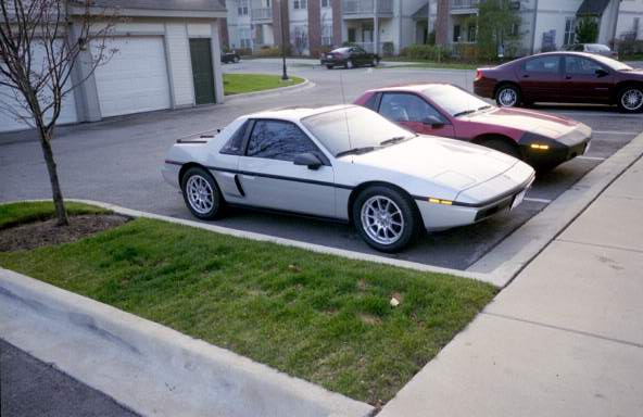

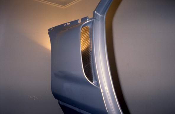

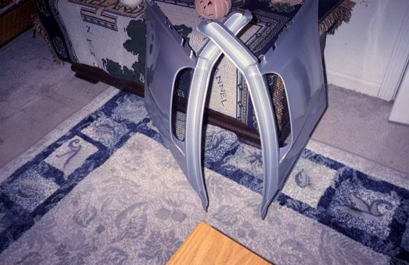

Here are the ones that are on my '85.
They are from FOCOA. They are nice & thick. (very thick) I didn't have any trouble installing them. (with exception of the mounting hardware. Thanks again Oreif)
They come cut & ready to paint. I didn't like the screens that came with them so I made some out of '85 engine grate mesh.

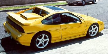

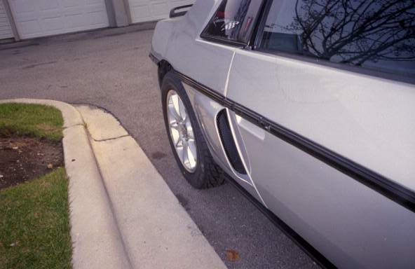

This thread has some of the only installed pics of the scoops... unpainted- but installed: https://www.fiero.nl/forum/Forum1/HTML/014346.html

Those last scoops look kinda funny with the added trim. Are they missing a piece or something? Whoever has those installed on their car could you please post some pics when they are complete and again when they are painted?
Are there any other options out there for scoops?
Also, how difficult is it to install them? Is it just unscrew the old pannels and screw on the new ones? or do you have to do some fiber glass work?
Another question is have any of you noticed any difference in relationship to how your engine is running? Do they actually cool down your engine more? Does anyone use these in combination with a "deck lid scoop"?
If anyone has the answers please let me know, also any other info on this subject is much appreciated.

Well... to answer a couple of questions.
The scoops above are on Doni Hagen's car- read the above linked thread for installation info. And yes, they were not yet finished.
All forms of side scoops will bring some additional air to the engine- how that affects the engine compartment is specific to how you plumb it during install. Keep in mind that all scoops will bring more air in- but with that air comes additional dirt, water, and debris. (so change/clean your filter regularily).
The decklid scoop (commonly used is the 'stang-style) will help remove some extra heat from the engine compartment- but this is also what the side vents next to the decklid to. If you really want to evacuate more of the hot air- a combination of the vents and possibly some electric fans could be used. (Although engine compartment heat has not been blamed for many problems aside from melted ice cream after a grocery run- put it inside with you )
Finally- if you're engine is running hot, venting air from behind/around the radiator can help. Installing a vent/grill above/behind the radiatior on the front hood would help this as well...
The above statements are most of the different body mods I'm planning for this spring/summer: Deck Scoop, Hood Vent, and Stage-2 Side scoops (if I can cough up the dough shortly here). So some of the stuff I stated may sound scientific- but I don't have any tests or reports to back up these findings (except the ice cream thing).

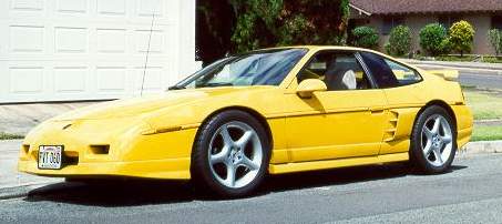

Report this Post02-21-2002 04:58 PM Click Here to See the Profile for Mr. FarknockerSend a Private Message to Mr. FarknockerDirect Link to This Post
Farknocker

  • The "Mecham" Style scoops (as seen above on Farknocker's GT) which have the "inserts" in them.

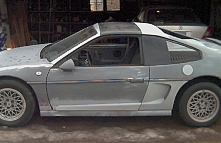

  • There is the "Pontiac" Style scoop which appeared on Fiero prototypes (as seen above on Haze's, Oreif's, Sage's, and Zoom88's cars).

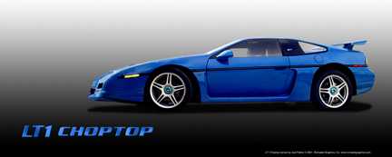

  • IRM "Integrated Rockers" w/Scoops as seen on cars like LT1 ChopTop's, Haze's Old Maroon GT, and the PPE

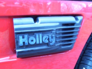

  • Last but not lest expensive is the add-on type scoop (like the Holley Scoop and other aftermarket similiarities)

    hey farknocker, is that ur car? where did u get those rims? what size are they? LMK, thanx Jason

    Got 'em from the Tire Rack while I was in Vegas. They are forged aluminum Antera 121 from Italy measuring 17" X 7.5" Unlike most knock-offs, These have the hidden valve stems located near the center hub.
    Here's a shot of the wheel and scoop from another angle.
    Farknocker

  • Holley side scoop: Real Holley Scoops sell from $100-200 on Ebay on a regular basis. Aftermarket similiarities can be found in the $20-$50 range from FieroWarehouse, RaceTech/FieroShop, and BBJ Resin Specialties.

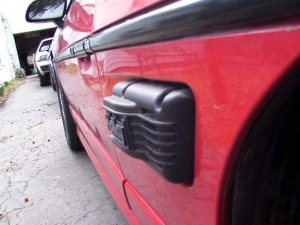

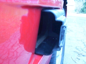

  • Holley side scoop: Real Holley Scoops sell from $100-200 on Ebay on a regular basis. [/B]
  • Or, if you are lucky and happen to be at the right junkyard at the right time, you can get a genuine Holley scoop for $2.00 like I did a couple of weeks ago.
    Yup... that's why the pic I used above was yours, and the link to the thread you originally posted. Nice Find!
