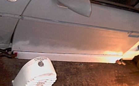

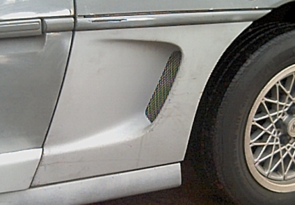

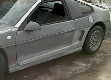

Okay, I got back earlier than expected. Actually, I cancelled a minor meeting to get home and play...I don't have enough free time anyway!
HERE THEY ARE!!
I found the easiest way to adhere the door pieces is to remove the lower skin screws and clamp the piece on while it dries. Everything else goes on pretty trouble free but a word for GTs...If you can, get "non-GT" front fenders and door skins. Otherwise you've gotta fill the mounting holes..especially in the front fender. It's not hard to fill them but if you don't know how or trust your abilities, get the undrilled parts. The scoop itself is a "drop in" but you have to remove the mounting tabs for the aero kit from the rocker panel.
I'll answer any questions for anyone installing the kit if need me to. BTW, the scoops by themselves look good with the regular "aero" door and front fender parts if you want to go that way.

Damn Damn Damn!!!
This is pretty exciting for me... been waiting to see more of Aus's handiwork. Very impressive...
Keep the photos coming when you can; I'm soooooo sold now!!!

I like the look of but I wonder about the amount of usuable space behind them because the inlet is so far back unlike other scoops I've seen. I would like to install an oil cooler behind the passenger side. Do you thing there is room back there?

Here I was getting together some nice diagrams and all Doni. Well I still will finish them. The door panels I didn't get to mention need trimming if they appear to stick out too far. Wife has had me away from the house most of the weekend so I haven't emailed you yet. But it sounds like you used my favoured method. Clamped. Did you use an epoxy glue?
Doni Hagan
Posts: 8242
Total ratings: 127
Report this Post02-10-2002 08:36 AM Click Here to See the Profile for Doni HaganSend a Private Message to Doni HaganDirect Link to This Post
AUS,
I tried a couple epoxy-based adhesives initially but found that they didn't "flex" like the door itself. I eventually used the same stuff ("black" urethane from 3M) for windshields. It's flexible, will last as long as the car and cleans up with acetone. If one's careful, you won't have much to clean up anyway.
Also, I used a Dremel tool for trimming the parts to conform to the existing body parts. Some trimming was necessary to get the door piece in profile (as you stated) but no big deal.
Overall, I'm quite satisfied.

Finally side scoops for the Fiero that will get the ultimate praise: "It looks stock". Aus you are to be congratulated on your brilliance in not overdoing the design. Many who have done a side scoop in the past have over-reached the design intent of the original Fiero designers. You Aus have perfectly incorporated the age old axiom of "form follows function. I will be getting a set myself as soon as I save the money. Trully inspiring work.More pic please.
