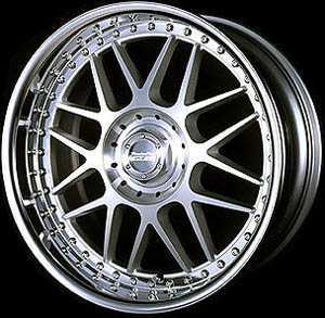

Ok, why is it so hard to find wheels I want for my Formula! These are the two styles I really like so far:
The Konig only comes in 17x7" sizes, and I want 17x8 front and 17x9 rear. I emailed Speedline asking them about their wheels, and they haven't returned my email, so I don't even know if they make them in my size.
Anybody have any other suggestions? Two styling cues I'm looking for are the rivets along the edge of the rim and visible lug nuts. I don't really care for most wheel designs with a cover over the lug nuts. And I'd like to keep the weight as low as possible, but I'm realistic. I don't want to spend $500 per rim if I can help it.

Yeah, I really love the Konig Imagines in the Black Opal finish, but they only come in 17x7. The largest tire I can run on a 17x7" rim is a 225/45-17. What's the use if it's only 10mm wider than the stock size? I want to run at least 235s on the back, and if I can find 17x9's I'll be able to run 255/40-17's on the back. 225s are just too small to justify the expense of new wheels. Now, the 225/45-17 would work fine on the front, so I could get away with the 7" wide rim, but I want to run larger tires in the back.

Well, 235/40's would still require a minimum 8" wide wheel. I could go wtih 235/45's on a 7.5" wide wheel, but I'd really like to get a wider wheel, even for those sizes. I found a Racing Hart wheel that's close to what I'm looking for, except for the covered lug nuts. I can get it in 17x9. Now all I have to do is brace myself for how much they're gonna cost.
