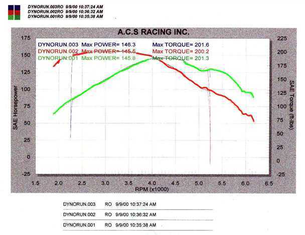

My 3.4 dynoed at 146.3 hp and 203.X ft*lbs of torque.
that was with the restrictive spiral max and I removed the air silencer which means I get hot air into the engine.
I am going to port the TB and intake. I am rebuilding the 3.4 now because a valve let go and destroyed a piston and bent a rod.
also have ported heads, intake, SI valves, sprint headers, 3.4 injectors adjustable FPR @ 45psi, hollow cat, and IRM dual exhaust, 1.52 roller rockers and crane 2030 compucam .423"/.423" lift.
My complaint is the cam doesn't let the engine breath after 4500. this is a bottom end cam. maybe the porting of the TB and intake opening will help as well as maybe getting WCF velocity tube.
I still smoked every mustang I raced over 110 mph. Got the car up to 4800 rpm in 5th gear with 225/60/15 tires on the back.

(lous dyno sheet)
you'll be in the low 14s in the 1/4 with 0-60 in the mid to upper 6s.
0-60 in 4.91

Report this Post10-16-2001 03:40 PM Click Here to See the Profile for lou_diasSend a Private Message to lou_diasDirect Link to This Post
notice the breathing problems over 4500
and that @ 5200 rpms I have 125hp and 125 ft*lbs

Hey 1fst, have you done anything to that motor or is it essentially a stock motor? (as stock as a transplanted engine gets )
Thanks for posting that dyno run too! Very nice.

Travis with lou having those numbers there I think he should be in the upper 5 to lower 6 sec range to 60 and the qtr in the mid to upper 14's. When I dynoed my Fiero I ran a 50 shot and got 145 hp and 214 torque as my peak numbers and with a 50 shot I was running high 14's. Of course this was with my auto tranny and if Lou has a manual then I am sure that can play some sort of part in the qtr to get faster times but I still think those numbers are good for at least low 6's to 60 depending on how he drives it.
I could be wrong though of course. Just saying. One way to find out I guess.

is it me or dose that dyno sheet look funny?
arnt HP and TQ supose to intersect at like 5232rpms. some thing around that mark. i'm assuming that one line is for HP and the other is for TQ.
they both kinda look like hp now that i look at it again.
[This message has been edited by GTMike (edited 10-17-2001).]

Report this Post10-17-2001 08:58 AM Click Here to See the Profile for FormulaSend a Private Message to FormulaDirect Link to This Post
that must be a big block 3.4.......
Actually thats a lot of power on the bottem end of the range, Do you shift at 4000?
If you look closely you'll see that the curves have different scales. Torque is on the right side and HP is on the left
I am right there with ya! I thought so too

I'd say in the Fiero application there is a little more power judging by 1FST's dyno runs. He's getting approx 145 HP and 200 Lb-Ft of torque. I think your supposed to figure about 15-20% for driveline losses, so the actual output of the engine would be about 170 HP and 235 lb-ft of torque... give or take about +/- 5. Those are somewhat rough calculations, but probably not too far.
