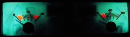

Well, I've got good news and bad news regarding the backlit indiglo gauge faces I've been working on ( https://www.fiero.nl/forum/Forum1/HTML/010075.html ). First the good: I've finally figured out the printing/production process to print them 4 complete sets at a time. Also I've gotten the first component installed on my GT (AUX gauge-see photo).
The bad news is that they don't work as intended. First off, the blue glow appears green due to the yellowish light of a stock 194 dash bulb (this could be fixed by using "hyperwhite" bulbs, which are rather expensive). Second- the variations in the plexiglass backing can be seen in the illumination, showing through quite clearly really. And the third "strike" is that the lighting is not powerful enough, or evenly distributed enough to light the entire panel evenly (see photo for all 3 problems).
Well... I'm certainly glad that I didn't start taking pre-orders or anything . I'm not giving up just yet though. If anyone can give me a number/contact for an EL paper supplier- I may try that route yet. For now I will probably produce a set of "regular" white face guages (only numbers are lit at night, not the face itself) so that I'm at least satisfied with their general appearance in the car. I'm also thinking of contacting some of the current manufacturers of indiglo gauge faces for imports- to see if they can produce at least a limited number of pieces (since I've got the vector-base graphics already complete). So that's about it for me... not a real happy night last night after it didn't work out.
BTW: for those who are also interested in my Clear GT Taillight conversion ( https://www.fiero.nl/forum/Forum1/HTML/010073.html ) I'm now only waiting on 2 Red LEDs before I can complete the first set. They should be arriving today or tommorrow, and I should have pics by the beginning of next week at the latest!

I have indiglow gauges in my car..I'm wondering about your setup...
I Stripped off the old gauges completley
Made new templates for the white gauges to be glued onto. The base is Plexiglass witt he back painted white(This is so that the gluing surface is clean.
I had my printer print the gauges off on a white plasticlike paper (not mylar..but similar)
I used sprayglue to hold the gauge faces onto the plexiglass.
Then I Put my Sections of Durel over the gauges.
My only problem is blowing inverters. I have also found my printer can print with illuminescient ink (Glow in Da dark) I'm wondering how the ink will show up with the EL sheet. Mine are printed with normal ink.
There is a site on the net where a guy made white face gauges then made them indiglow. I believe it was on an eclipse. This is where I first got the idea.
I'm pretty fed up with the inverters popping, so my project is on hold. I was thinking of just swapping the gauges to Autometer white face units.

JM- My gauges are similiar to yours in application, just without the Durel.
My gauges are made from 3 layers of a white-frosted backlit material desgined for tradeshow & POP use. The front layer is front-printed with only the numbers, letters, and the checker pattern. There is then another white backlit layer- nothing printed on it. Then the back layer is printed with the blue color and white where anything else is (Redline indicators).
All three layers are lined up and mounted together using an optically clear adhesive film (much like an auto manufacturer uses on their gauges). The back layer is then stuck to the plexi and reinstalled in the car.
My problem is primarily the uneven lighting of the gauge (doesn't light the whole thing). The system really needs another lighting source (EL Paper or Durel... same difference) to illuminate them correctly.

Rob. I had similar problems with my first set of white face gauges. I found brighter lights are needed. I am still looking into the best option before I go to the expense of screen printing new faces for general release. Fluro lighting is looking the best.

Minn: try gettting your mitts on some diffuser material. Maybe a little thicker than a single sheet. I have some on the backing of my laptop that would work nicely. let me dissect it, and see if I can't give you a solution. I have a fairly good idea. what's the maximum thickness of your inserts?

If you could find some of the plastic "light pipe" used in back lit laptop displays, or something similar... This stuff takes light from the edge and evenly distributes it across the face.
You'd have to figure out how to work with it but it might solve some issues. This combined with some additional masking.... I.E. don't try to light the whole gauge, just the area with measure marks.
It would take some fooling around but I think that option could be used to nearly eliminate shadows. You might still need brighter light bulbs or maybe white LEDs to get enough light to the "light pipe."
For example,,, if the "source edge" of the light pipe faced the bright section of the gauges in the above photo, it would carry light all the way across the markings. The idiot light areas would be a bit tricky.
