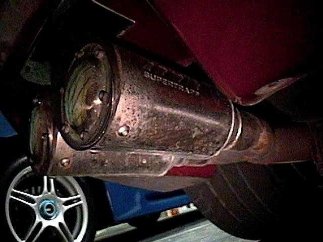

Supertrapp Dual Twin Exhaust System! www.supertrapp.com
Adjustable for backpressure and tone. I run 5 disks per tip. Very exotic sound!

I have 4 Supertrapps on my Chevelle,the sound is adjustable and they rate them by what horsepower they can handle.Mine are 250 HP apiece.
