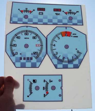

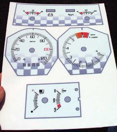

This is another project I've been working for awhile. So far, the only thing I've had to pay for was the ink in my printer. The rest was all free samples.
A Little background: I'm a graphic designer/digital printer for a portable tradeshow display company- as well as just starting a new Graphics/Wide-format company. This basically gives me access to a few medias that most people wouldn't think of. I have seen the white-face gauge conversions as well as backlight-white faces, and even on ebay a "REAL" indiglo gauge set. Well, import drivers have easy access to these types of things- but not us.
So I've used only 2 different materials: "Trans-White" backlite film (usualy used in light-boxes like you see at the airport or tradeshow), and 3M "Optically Clear Adhesive" which is commonly used in automotive gauge applications as well as layering digital components like touch-screen displays for your palm pilot. I used the optically clear because it is rated at 98+% light transmission- this is the expensive stuff. I don't know exact costs on these materials, being they were all samples from business associates- sorry.
I started by front printing the white (outer) layer of the gauges on the TransWhite, then on a separate sheet of TransWhite- backprinted the blue layer. I then apply a layer of Optically clear adhesive to both sides of a blank TransWhite page for spacing. Then the front is attached, followed by the back. Another layer is then applied to the back side of the set- to be used to apply the face to the gauge-plate.
I have not yet recieved my sample gauge set to use as a prototype, so the pics are just handheld digital photos of the printed sheet. They do still have a slight bluish cast to them when not-backlit, but become a rich-lite blue color when backlit. I am going to try to produce a second set shortly to see if I can streamline the process.
If anyone happens to have a digital file of the inset warning lights (high-beam, turn signals, service engine, etc...) they could send me, that would be great!
So, what do you think?

Looks schweet Me likes

Kempo will buy a few sets from you when you start mass producing them. Awesome idea!

Wow They look great! You could try some more funky stuff like your checkers or the Fiero Emblem that only show up when you turn the lights on or something.

Hey, those are nice! I like the design.
Anyway of doing the "face" on the A/C control panel? I've looked into it a bit. Seems like it could work. Just need to scratch out all the orange paint stuff around the light hole.
Oh yeah, you need to fix the temperatures on the gauge. They're a little low

    Sqoach... I never even noticed that!!! I got the original layouts from AUS... must be in Celcius (sp?)... I guess I'll have to change that on the next set! Good Eye! Thanks.
    About the A/C panel... I guess I'll just have to take one apart to see!
    Someone asked me off-forum about different colors... I guess I can print them in any color my printer will do- I'll try sometime and see what else I can come up with!

    Wow Rob, those look great!!!
    I've been trying for a while to find a contractor that would make me just 'blank' indiglo circles that we could then cut and laminate and print whatever gauge designs we wanted onto, but no luck yet.
    Yours do look quite good, and I've had recent expierence with using acrylic block as a marcro lightpipe and diffusior with high intensidy (5 and 10,000mcd) white and blue LED diodes...
