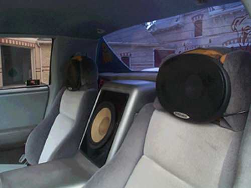

How's this for headrest speakers?

WHAT WAS THAT? I CAN'T HEAR YOU WITH THIS SPEAKER IN MY EAR .
