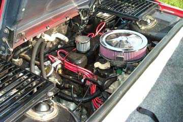

I was talking to a friend and he has a spare 4.5" cone filter I bought it from him for $20.. (oh RodrV6.. you can have my stock K&N) well it would drop right on the stock intake tube.. but the temps would be just stoopid high.. and the sucking noise was unbareable in the car. you couldn't hear yourself think! anywho.. so i went to the shop.. and found a 90* 2.5" bend and an 11" piece of 2.5" tubing (the piping we use for turbo hard piping) measured and cut welded and drilled a BIG hole. after asembly i closed the hatch and POOF.. no annoying sucking sound and a larger volue in the intake.. well the dyno computers were sut off for the day but we were running the 1/8 anyway..
all last weekend i ran consistant 10.0++s... well this sunday i ran 2 9.8++s at 67-69mph a 1 9.9++!!! Pics and time slip to follow in a few minutes.

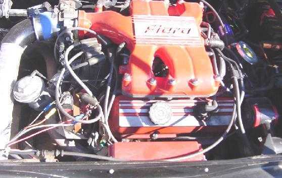

the prototype intake...
notice the throttle body coolant by pass also... that was done months ago...
