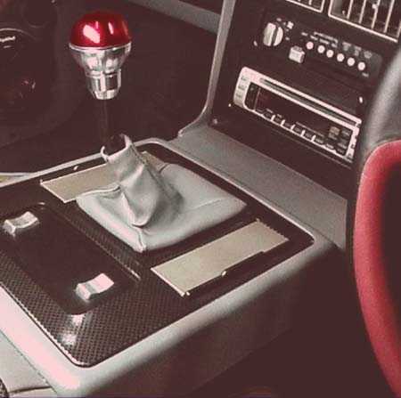

Here is a couple of detailed pics of my door speaker pods that people requested.
The original post was. https://www.fiero.nl/forum/Forum1/HTML/006816.html
Long overdue, sorry. But between running my business, and other stuff I don't get a lot of time.
Update on plans for console sub box from the same post will follow soon.
Sorry about the image file sizes but they are large for better detail.
And a couple of off topic detail shots of other interior bits not visible in the original post.

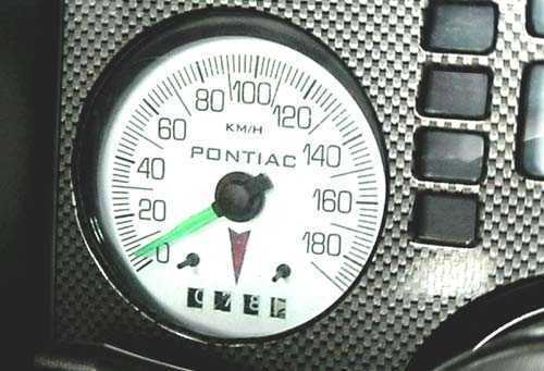

Yes I put the speedo needle back on in the wrong spot.

The whole interior is on the other post listed KR.
The pods are home made, shapped from layers or mdf board then sanded to shape, glassed over then sent off to have a moulded vinyl skin put over them. The last part of the process was not cheap.
The speakers are 5 3/4" but I made the pods to take 6" as well. The tweeter sections of the pods I designed to fit most makes as I may want to change one day.
If there is enough interest I will start making them. But to say costs will take a new mould off the now vinyl looking pods as the custom route cost big time . The new ones would look identical to the pictures but would require painting to you own colour and would be made of fibreglass. Heavy duty laminate, not paper thin.
I don't know if they are to dear for yous but I can sell them for $50 US a pair and appoximately $10 US shipping costs.
So anyone that is interested please e-mail me and I will start a list. If I can get 10 orders for them I will make them.

You mount them with 4 to 6 self tapping screws from behind your doortrim. I think 6 is better. The stick out approximately 3". I found at first I hit my foot on them getting in but soon got unconsiously used to them being there.

So, how often do you get up to 190 mph?

check the pic again sqoach - it's 190 kph
