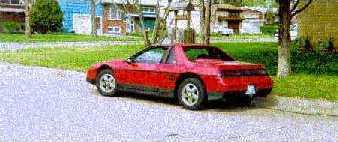

Wolfhound
Posts: 5317
From: Opelika , Alabama, USA
Total ratings: 113
Report this Post05-03-2001 10:00 PM Click Here to See the Profile for WolfhoundClick Here to visit Wolfhound's HomePageSend a Private Message to WolfhoundDirect Link to This Post
Fierodave2001, Steve is right, with a little modification you could put that pretty blue 87 inside.
Love the car!
