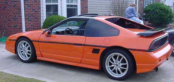

i had 215-40s on the front of my SE and 245s on the back and the ride was tough!
the SE www.fiero.nl/uploads/travis.jpg
my GT has 215-45 (f) and 235-40 in the rear on 17x7 up front and 17x8 in the rear.. if you have a 7" wide wheel don't go over a 215 if you have a 7.5 a 235 is fine but a 245 is to large.
http://www.miata.net/garage/tirecalc.html
got this from the miata forum i'm a member of... same screen name just differnt car..
my car... www.fiero.nl/uploads/1fstlow.jpg
