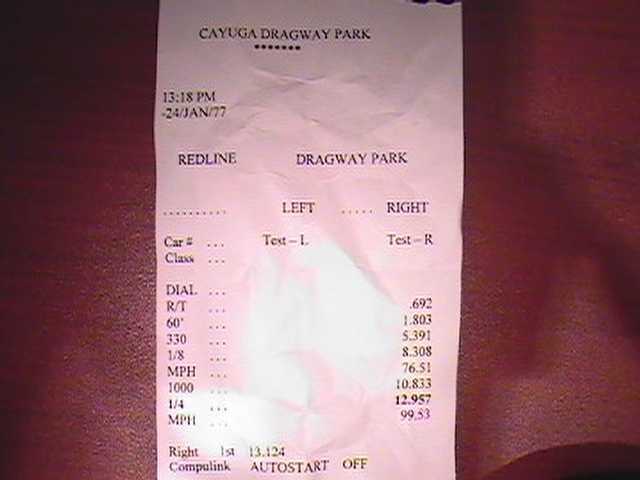

Report this Post01-20-2001 12:03 PM Click Here to See the Profile for Sillhouette.comClick Here to visit Sillhouette.com's HomePageSend a Private Message to Sillhouette.comDirect Link to This Post
How come you don't get anymore rise in pressure past 2500 rpm?
I run 12.9 in 1/4 drag slick. What do you run?
[This message has been edited by Sillhouette.com (edited 01-20-2001).]

Report this Post01-20-2001 12:48 PM Click Here to See the Profile for 88formulaClick Here to visit 88formula's HomePageSend a Private Message to 88formulaDirect Link to This Post
12.9 in the QUARTER MILE! Man what the blank kind of motor do you have in your fiero. It can't be a 2.8-liter motor can it? What was your mph?
You need about 280-300 horsepower to run a 12.9 in the quarter mile with the five-speed transmission

Here is the 1/4 mile sheet. The engine is a bored out 2.9 with custom pistoms roller rockers crane cam balanced bottom end. Full stainless steel exhaust using stock manifolds and a larger cat. Port / polished throttle body intake runners. RSM supercharger G90.

Quick note, I've never seen a 12 sec 1/4 mi run at under 100 mph. Same way with the 1/8 mi times, very low mph for the et. I wouldn't bring this up if the 60' was some heller 1.5-1.6, but a 1.80 is slow for the et posted. Also, which track is open in Januray? Is that date Jan 24, 1977? I've only see these big variances in et/mph in pure drag cars, that have a dedicated suspension to put down the lowest ET possible (normally have ET's lower than the normal street car with the same MPH).
In contrast, my Stang always runs a higher ET for the MPH, mainly because I don't speed shift and I don't launch as great as other drag cars. My 127 mph (at 3400lbs)normally equals mid 10's, but I'm only doing low 11's for the present time. (I've even done a 7.2 @ 106 mph at the local 1/8 mi track, which should be mid to high 6's).
Weird.

January 24, 1977??? You must be running the super prototype Fiero, huh? Is that Cayuga, New York? You get good traction on ice.

i know your not knocking Engineered Donald.. that does suck that your seals are wiped though...
my 13.6 run on nitrous was at 103mph. my 14.1 times on street tires were 94-95ish!
but in his favor.. the date on my runs say sept. 20th 90 when it was really july, 31 99.

Here is the example I was pointing out, I've inputed Sil & Trav's ET/MPH and guessing weights would be the same (both have no AC I believe). Here is the link for the program http://www.corral.net/tech/brakehp.html :
Sill's run:
Initial Readings
READING OUTPUT UNITS
WEIGHT 3000 pounds
TRAP SPEED 99.5 mph
E/T 12.9 seconds
Dyno Readings
Total Horsepower 235 bhp
Horsepower Used 276 bhp
Best E/T 13.60 seconds
This is showing that Sill is using more horsepower than is avail. His best ET given the MPH/weight should onlyn be 13.60.
Travs:
Initial Readings
WEIGHT 3000 pounds
TRAP SPEED 103 mph
E/T 13.6 seconds
Dyno Readings
Total Horsepower 261 bhp
Horsepower Used 235 bhp
Best E/T 13.14 seconds
This shows he was using less HP than he has to get that 13.6 time. It shows that if he used all of the HP avail, then his best ET based on MPH/weight should be 13.14. This is normal, people haveing slower ET for the MPH given because of a ton of factors (number one being most cars don't have optimal drag suspension)
For giggles, here's my Stang:
Initial Readings
WEIGHT 3400 pounds
TRAP SPEED 127 mph
E/T 11.13 seconds
Dyno Readings
Total Horsepower 555 bhp
Horsepower Used 487 bhp
Best E/T 10.65 seconds
Of course this is only pushing numbers, and this is close to reality that I've seen, but of course there will always be some deviations of this.
