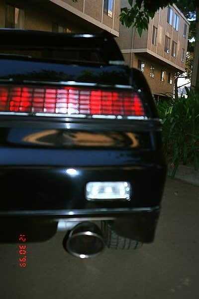

More info to follow. BTW--These aren't mine, but I think I'll do them. Pretty cool idea.

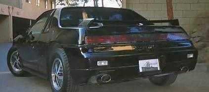

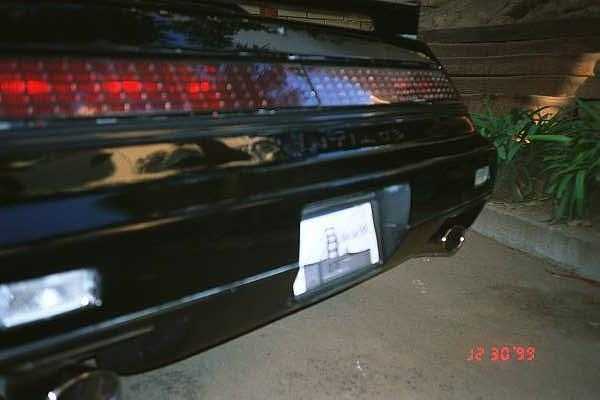

THANKS MONKEY!!!
This is easy, the only trick to it is
finding long enough screws to mount the
lights, (2) on each light just like
some front turn signals on many cars
I had to use extentions = a 2 1/2"L
hex with a screw on one end and a threaded
hole on the other end, I think it was
8-32. You need this much to mount because
the steel/frame in about 2" in (deep) from
the facsia!
It looks like many cars have the lights that would work I don't remember the name brand of the lights off hand I got them from Grand Auto.
I hope this helps.

ANY TRAILER BACK-UP LIGHTS WILL BE EASY
TO INSTALL, THEY ARE MADE TO HOOK RIGHT UP TO YOUR BACK-UPS. NO FRAMES, THE SCREWS GO THROUGH THE LENS. JUST LOOK AT SOME CARS TURN SIGNAL THIS IS THE TYPE OF LIGHT YOU WANT. THEY ARE MADE THE SAME AS THE FRONT TURN SIGNALS ON THE FIERO!

I like the exhaust tips,where did those come from do you know?
DXR_DAD
Posts: 2440
From: so. san francisco, ca
Registered: Mar 99
Report this Post06-17-2000 01:09 AM Click Here to See the Profile for DXR_DADSend a Private Message to DXR_DADDirect Link to This Post
Thanks lowCG
Those tips were a gift from my son. He got them from one of the local speed shops.
I think Super X sell this brand or some
very close.
