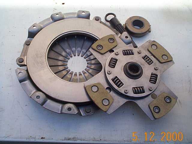

Here is what my new kevlar clutch specially designed for the V8 Fiero conversions.
What do you think?

What do I think? I think it looks like a clutch. LOL
Seriously though... where did you get this thing, and for how much? V8Archie?....

call me crazy but don't clutch disks usually have more than 4 blades on them????? Anyways someone needs to talk McLeod to making a clutch I hear thoose do not fail. Can any old joe call centerforce and get one of thier clutches or do you have to get them through archie, ace, chris west, etc?

First off, this clutch is a racing style clutch that is used on performance cars. So this shape is nothing new to those in the know. What we have done is incorporate the knowledge that there is and designed this clutch specifically for the V8 Fiero. This clutch has aprox. 2400 lbs of clamp load just like our clutch that we now produce but with the ability to withstand up to aprox. 450 hp. Where can you get this clutch you ask, well thru me since this is built specially for the Fiero Shop.
Also if you notice that this clutch has six pins holding the plates that hold the springs together. A stock clutch normally has three pins while our stock kevlar has four pins and our new kevlar clutch has six pins. This disk is a custom disc which is not found on the average parts store nor can anybody get one of these designs until now. The reason a person can get one now thru me is that it is built for me and the Fiero. Also this clutch can be used in the stock Fiero.

Nice, too bad my V8 Fiero is an automatic. Does the line-up tool come with it too?

Look at about the 2:00 position on the pressure plate, the alignment tool is the piece with the "ring" on the end of it that's between the pressure plate and the release bearing.

didn't mean to offend but I thought the more surface area on the clutch the more holding power it has. I also was under the impression the more discs the merrier. Then it was phrased badly but I asked if centerforce fiero clutches were available to everyone. I was not implying that thats who made your clutch, if it is, it was just a lucky guess.

How is the street drivability -chatter on take off, stop and go traffic etc.?

Hey Larry, I should of been more clear. Yes, I saw the alignment tool laying there in the pic next to the throw-out bearing (trust me, I've seen them and used them before). That's what prompted me to ask if it was included with the clutch. I was just wondering if everything in the pic was included in a package deal.

Hey batbot, yes everything that is in the picture is included. As far as chatter, no there is none. Dan86gt, no my clutches are not made by centerforce, they are made by a small company which is getting bigger everyday, this company is into custom made clutches and has build many racing and performance clutches as my stock clutch. For those of you who have not seen a picture of my stock clutch, just go to my web site and I have several pics. of it there.

The clutch looks pretty, but I find it hard to believe that a 4-puck clutch won't have any driveability issues. Just ask 1fst2m6

To my knowledge, this clutch has been tested excessively as it is essiently the same clutch as used with racing engines. As for its use in the Fiero, it is my understanding that it has been tested with V-8's in the 400 h.p. range for street and competition use.
I don't think that the number of V-8's the Fiero Shop has installed even matters at this point as this was just a posting to allow others who maybe interested in a quality clutch for a V-8 install that this part is available and gives them an option over others available on the market.

pull those springs out and Paint the pressure plate yellow and it looks JUST like mine and BlackGTs! (our pads are Cindered Ceramic/metallic though not kevlar; kevlar will slip a bit more than Ceramic AND since it's sprung that might help too...) BUT if you talk to ANY clutch manufacturer they will all tell you that the reason for the springs is more for engine harmonics and driveline shock than clutch dampening... www.clutchnet.com (sorry to let the secret out) for the same clutch setup with either ceramic or kevlar pads... ! the unsprung verson is only $55 (now, and is the disk and alignment tool ONLY I'D recommend a STOCK pressure palte if your gunna drive in traffic, right Todd) i don't have drivability problems till it gets hot.. as long as you ONLY drive to the stop sign at the end of the neighborhood you'll be ok... BlackGT has almost the same clutch.. i'll bug him and have him toss in his $.02 they are GREAT, racing or weekend flogging clutches! and will hold over 300lbft of torque! so if your serious about speed and you want the BEST performance these are the clutches for you!

to dxr_dad, Let me say this. First Terry is not the seller I am. Second if you really need more info then call my supplier and talk to him directly. He and I went round and round the block trying to figure the problems that the fiero has had. Look in the Golgen Gate Fieros newsletter for my suppiers name and tel.
As far as using metals and some ceramics they are great, but has anybody seen what they do to your flywheel and prssure plate, I have. Has anybody seen some transmissions busted up, because of no springs in the clutch, I have. In both cases they did not look pretty. I don't mean to start a war but you asked a question and posted an answer. I personnally feel that every person has to make their own choices and live with them. If you feel that you have a better clutch, then more power to you. As far as this post I placed a picture of a clutch that I carry, whether it be made by an independant manufacturer or a name brand was not the issue. If anybody cares to discuss this please feel free to call me and I will answer your question. This post is and was not intended to say what clutch was better or which clutc was not, it was simply a posting of my clutch and I asked what you thought and not what else is or was available.

the ceramic pucks will TRASH your flywheel! i had my pressure plate run through a cryo process and there is no major wear. i've got 6000 miles on it. if your not willing to replace your flywheel everytime you replace your clutch DON'T buy a ceramic unit. I was willing to sacrifice a few parts for better performance. and the spyder gears in the diff many not be strong enough they will be the first to die and toss chunks into the rest of your nice shiney tranny and send it to the scrap yard.
