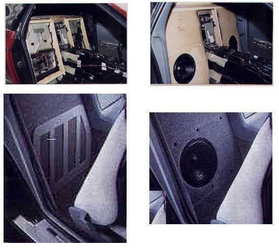

These pics were sent by a friend who found them on the net. He is going to do it to his Fiero. What does eveyone think about this? They are 10" woofers. He said the fierwall is doublewalled so there is no modification to the outside (engine side) firewall. Just the initial cutting and sealing is required.

I've seen this mod before, though I actually haven't heard what it sounds like. A buddy of mine worked for a car-audio shop, and told me about a similiar installation they performed on an '87 GT. It involved cutting into the firewall (as shown in these pics) and entailed lots of work. The end result, though, sounded "AWESOME," in his words. I don't see why it would hurt your beloved Fiero, other than if you were concerned about keeping it "factory." Then again, I don't know of any Fiero owners who can do that!

Any cutting of the structural members will weaken the frame. If you care?

Greg - that's a 6 year old photo. The website deals strictly with the stereo installation, but there's more than just "big speakers". Perhaps you should go to my website to get the full story, if you haven't already done so.

I realize your concern... but you are not weakening the structure. You are cutting out a small section of the sheet metal firewall within a 10" structural channel welded across the firewall. If you cut out the channel or its welds, then yes you have weaked the structure because the channel (not the sheetmetail firewall) is where the strength comes from.
You utilize this space within the channel, to give you a "well" with the depth to accomodate the speaker magnet. In this way you can build a shallow sub box, which takes up minimum space behind the seat. It's work to install - but the results are worth it.
Spyder is following this route, and using fibreglass to seal the well - probably the easiest way to do it. Here's his comments:
"I remember seeing your car in one of the car audio mags, hope it was yours. They didn’t have any pics of the process but I remembered that they said it had the double firewall. Before you had your site. So I tried my best to see what I could come up with. And here is the pic of my first try in fiberglassing I had to put a piece of paper in the cut out section so everyone can see it. And I did work on the color of the pic to see if it would show up better."

Fierosound & Spyder,
How did you guys cut the firewall.. metal cutting saw or a torch?
I wouldn't mind doing this setup myself, but I've never done any sheet metal work of this type, only a bit in shop class.. which is a little different than cutting a hole in the firewall.

Darklord...
DO NOT USE A TORCH!!!!
THE FILLER TUBE FOR THE GAS TANK RUNS THROUGH THAT AREA ON THE DRIVER'S SIDE!!!
Make sure you don't have any gas leaks, or gas that has spilled down along the tube from overfilling.
Use a jigsaw to minimize sparks. Keep your fire extinguisher (near the spare tire) handy when you work.
To cut out the firewall, drill a small hole about 12 inches up from the floor. Insert a wire coat hanger to "feel out" how large an area you can cut out. Use an electric hand jigsaw with a metal blade. It's better to start small - you can always cut out more. The gas filler pipe runs through the area on the driver's side - be careful!!
The "well" is in an 8" or 10" inch channel supporting the firewall. Each end needs to be sealed. Cut some MDF to fit and silicone into place. Some people are using fibreglass to seal this well - whick is probably easier. You need to seal this - otherwise all your bass will be "outside". There is limited space for speaker magnets. Buy high effeciency speakers with small magnets. I recommend OZ Audio 10" 250L subs. I only have 50 watts to each - and look at the results. 100 watts would be even better, but I'd have needed a different amp setup (probably 2 plus a crossover - more $$$).
"Try out" how/where speakers will fit and take measurements. You can use cardboard to help "size" the box you will need to build. This can then serve as a template to help build the MDF enclosure.

When I did mine, I was scared. There is actually a factory seam there (a small panel) so your basically removing a panel that they installed at the factory , I used a chisel and hammer. There are a few tack welds and a lot of caulking. After I removed the metal, I used spray foam around the edges to seal it. Then I cut away the excess foam and then did the fiberglass over it. (fiberglass, another story)
If I were to do it again, to make it go faster, I would use a pneumatic cut off tool. It doesn’t cut as fast a jig saw but it is more precise and you don’t have to worry about bending a blade or worry about hitting something on the other side. (and it makes cool sparks)

Fierosound is right about the gas filler tube behind the drivers seat. Be careful.

Fierosound you made the comment that you do not weaken the structure by removeing sheet metal from the area.
Well I can't say this any other way but YOUR WRONG.
The strength you will take away is called shear strength. I'm late for work. I'll give more about this later It's IMPORTANT!!!
Trust me, or ask Ogre!

Thanks for the heads up.. I only mentioned a torch because the area around the cutout portion looks blackened, but it could be paint or something else.
As for gas leaks.. I'd like to completely drain the fuel tank while working on the car. Don't want to take any chances at all.
Spyder, do you think removing the panels with a hammer & chisel would be easier than a jigsaw?
Do you think metal reinforcements could be welded or bolted on, under the MDF, to replace any strength lost by removing the panel?

Yes when you cut the metal you will weaken it. When you add the fiberglass, it is now stronger than the metal that was there. Also when you add the box structure, you add more structure to the car which in turn adds strength to the whole chassis. Sort of, like a, UNIBODY.

Thanks for your concern - but mines already been done 6 years ago WITH NO PROBLEMS. Nothing has twisted loose, fallen off, or rattles. It's unlikely I will be ripping out my subs to weld a patch in the panel. It's too late for me to change things!
But it's good you pointed it out for others who may be considering this install. They will have to decide on whether to proceed this way or not. Obviously, ripping the entire firewall out would be a BAD IDEA. If you are really concerned that it may weaken the firewall, I'd suggest cutting out the minimum amount required for clearance for your sub's magnet. In a 10" sub such as the OZ Audio, which uses a small high efficiency magnet, this would only be about a 5" hole!!
I think if you state your information, and alternatives for subwoofer installations, they will be better equipped to decide for themselves. I'm happy to just leave it at that...

I wouldn’t drain the tank, fumes would still be present.
Use a jigsaw! I was chicken when I was doing it. (I was not sure I was doing it right) Plus you might want to make it larger than what I did.
Once you install the sub box, you will regain any loss of strength in the removal of the panel.

Fierosound I was not knocking the sub install, just telling the tech side of things I personally wouldn't do it but it does look awsome! Del Sols had problems with flex so much infact if you auto cross them the rear window falls out of its tract. The Fiero is a lesson in structural and shear strengths. If even a small portion is reduced the space frame is compermized that is the design of the beast. However, sometimes cars are over engineired and have a little fat to be trimmed! I personaly bought the Fiero for a well handleing car not for a big stereo install. If I wanted a stereo car I would get a SUV!

Has anybody thought of trying a rotozip? It's like a small router. The depth of the bits can be adjusted to suit the job. I never did like using a jigsaw very much. I've worked with wood more than metal and there are much better tools to use on wood than a jigsaw.
As for the structural integrity, couldn't the hole be framed in with a heavier gauge metal, riveted, and glued with some industrial strength glue like what's used to glue the frame work in the hood of a car?¿ Maybe an offset angle iron? " ¬ ". You guys have my gears going! I'm thinking of putting this on my long to do list. If I can afford it, overkill is the way to go.

keep in mind while doing a firewall speaker install like the top of this thread that ventilation for the ECM must be provided. An overheated ECM is a dead ECM.
The vehicle battery needs to be disconnected before you start messing with any of this.
Under NO condition must a torch or other hot cutter be used to make the cuts you people are making. Even then, the rule is STUFF the gas tank and work out side. if there is no breeze use a fan. If you allow fumes to build up you're in tremendous danger. (I think it is a teaspoon of gasoline at stoic is equal to one stick of dynomite. Might be a table spoon. ain't much either way.) If you hit the pipe and spill fuel stop imediatly. clean up the spill and wait untill the fuel is dried up completely.
As for structural issues,,,, Yes, it could increase body flex. I don't know how much. Keep you cutting as small as posible. Consider using an 8" woofer. you're dealing with a pretty small space. A pair of 8's should work well.
Fiberglass does not compensate for the steel removed. First of all it's very likely that the glass will crack loose from the steel in fairly short order. If the glass is exposed to the engine compartment you create both a fire risk, and posibly a carbon monoxide inlet. You would be better to form a sheet metal pocket that is series spot welded into the hole and sealing that with hard solder.

I’m sorry. This thread is just a small portion of what is involved with a subwoofer install of this nature.
I sometimes forget that everyone hasn’t done the research and seen what others have done and what exactly is being done. I will try to shed some light on this subject.
So let the questions continue and I will answer the best that I can.
Please note: This is one of the many ways to do a subwoofer installation. You decide if it right for you.
I reread the post and noticed that on this thread that there are not much references on what exactly is being done and why.
The problem: due to the depth of speakers, the seats of the car would have to be positioned forward to the point of being uncomfortable. Having enough air space is not a problem.
A solution was discovered where the magnets of the speakers could be placed into a small cut out of the rear fire wall.
The rear fire wall behind the seat actually consists of two totally separate walls which are anywhere from 2” to 3.5” apart.
There is air in-between them. (a gap)
On just the inside firewall (inside the car) there is a place where you can make a small cut out, just large enough for the speaker magnets. After doing the cut it must be sealed. I used fiberglass.
Then you build a box similar to the one at the top of this thread.
As far as structural integrity: fierosound has had this install in his car for SIX YEARS with no problems.
If you are worried about the integrity, don’t try it.
Please visit fierosounds web site for even more info.

The main topic of concern here is possibly weakening the car's structure.
The cuts are within a C-channel welded to the firewall sheetmetal. The C-channel is there to strengthen the firewall and to prevent vibration, not the other way around. The integrity is still there, the same as your boxed frame sections that have holes in them for access to nuts or bolts.
I'd be MUCH MORE CONCERNED with T-top kits, Convertible kits, and body kits that require your to saw major structural portions of your car off!! Or those Lambo kits that require you to saw your car in half to extend the wheelbase!!

I was thinking about the comment that orge made about ECM cooling. If a persons really worried about it they could always mount a small computer cooling fan to help with cooling. I was forced to move my wifes ECM due to restrictions from mods. I mounted a miniture cooling fan and its worked great (3 yrs now) in keeping the ECM cool. I ran it to a 5 amp fuse in the block.
Just my .02c

I would have to say that this is one of the better sound systems that I have seen in a Fiero. It is definitly better then having two large boxes behind your seats and loosing valuable seat travel. The only thing that I don't like is having to rip the interior apart and cutting holes in the firewall. Very nice job on the installation.
I will still stick to my box plans which will hold 2 10 inchers with a lose of 1.25 inches of seat travel. My first box had 2 Kenwoods and the sound was great. It also takes 30 sec. to install/uninstall. This will come in handy at the track. The box itself is quite heavy and the extra weight does not help with 1/4 mile times. When I made my first system I removed the rear speakers, installed the sub's, a 200 watt rms amp and I kept the stock Radio and front speakers. This time I will change the radio and the front speakers but the rest will remain the same.
