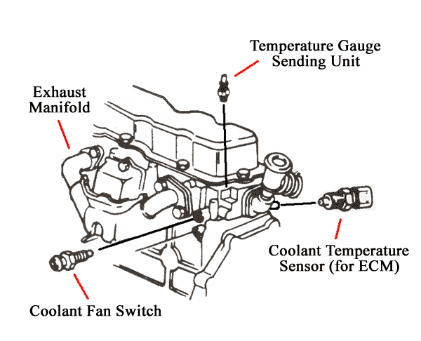

Also, I keep reading about the radiator fan module switch -- can anyone tell me where that is located? Is it near or on the radiator or the engine?

The radiator fan is controlled by the HVAC (on with A/C) and by a switch in the lower intake manifold near the thermostat housing.
