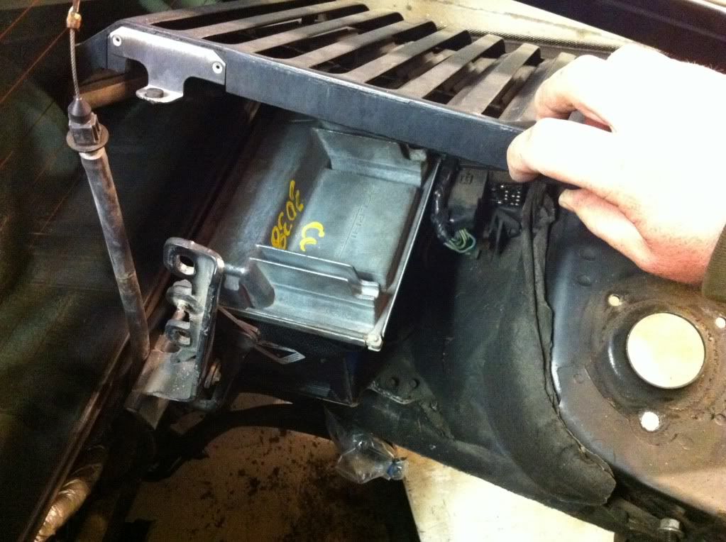

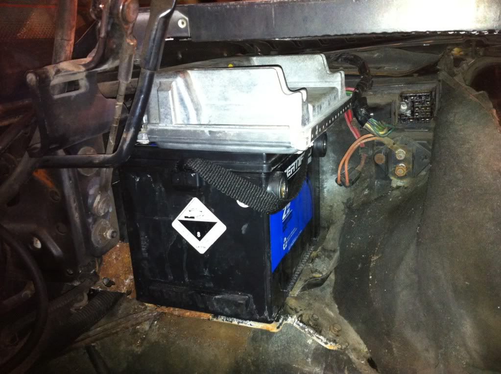

So I plan on putting my PCM on top of my Battery,

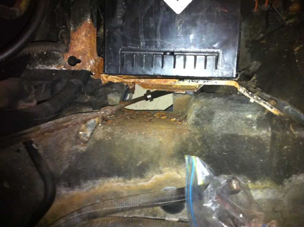

I have to cut out my rusted battery tray and I plan to lower the battery about a inch and put my PCM right on top, even if I didn't lower the battery it already fits. What do you think?
