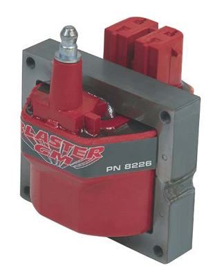

I've had an MSD Blaster coil in my 88 GT since 2004...
The only ignition related failure I've had was an ICM in 2005...

Mine looks a bit different, I have to look up the exact part number.
I've also used that blaster coil with success. On one 3.4L Fiero that I've owned since 99 and its still working. If you have bad plug wires it will put a strain on the coil. Maybe that's the problem that brings failures. As for the MSD GM coil pack coils, there are many reports of those things going bad on a regular basis. To avoid that I used only stock GM coils on my 3800SC.
