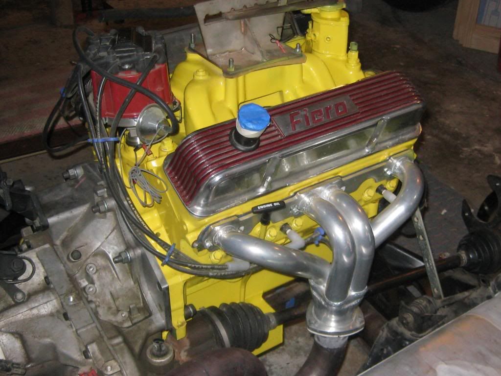

I took the dog bone off my 87 but replaced it with a diagonal brace that ties the rear cylinder head to the cradle. It seemed to me that the engine should be triangulated to the sub frame. Just welded a bracket on the sub frame and put a piece of 1 x .250 bar stock. It's under a tensile pull when the engine torque is applied. Probable more bar than really needed but it really did the trick.

Here is a picture of the brace I have been using on my Fiero. Kind of hard tosee but it's on the lower right side of the engine.
