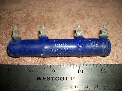

Oh and BTW,
A resistor is a device that resists, or limits, the flow of electric charge through itself, in the same way that a narrow or partially blocked pipe resists the flow of water through friction. The power source driving the current through the circuit generates electrical energy, and the resistor converts that electrical energy into heat energy.
http://wiki.answers.com/Q/W...and_how_does_it_work
It's how a dummy load on a CB transmitter (or any other transmitter) works as they are just resistors or resistor arrays. It consumes the transmitting power produced by the transmitter and converts it into heat.
I mean look at a multitap resistor.
The reason for the various taps is to get different voltages from one unit. Where does the voltage decreased go? Does it just magically disappear? No, it is turned into heat.
Adding Resistance
Using a resistor to change, for example, a 4-ohm speaker into an 8-ohm circuit for use with an amp that requires an 8-ohm load will work well, as far as amp loading goes. The speaker, however, will receive only a fraction of the output of the amp, as the resistor will take part of the current and convert it to heat. The voice coil of the speaker moves in a magnetic field while a static resistor does not. A speaker and resistor combination totaling 8 ohms will not be as loud or as responsive as a speaker rated at 8 ohms, connected to the same amp.
http://www.ehow.com/info_12...-small-resistor.html
But those are internet sources so you can dismiss them if you want. If you'd like I can go out to the garage and search for my electronics and car audio installation course books, then scan and post scans of the pages. I think I might know where one of the books is.
