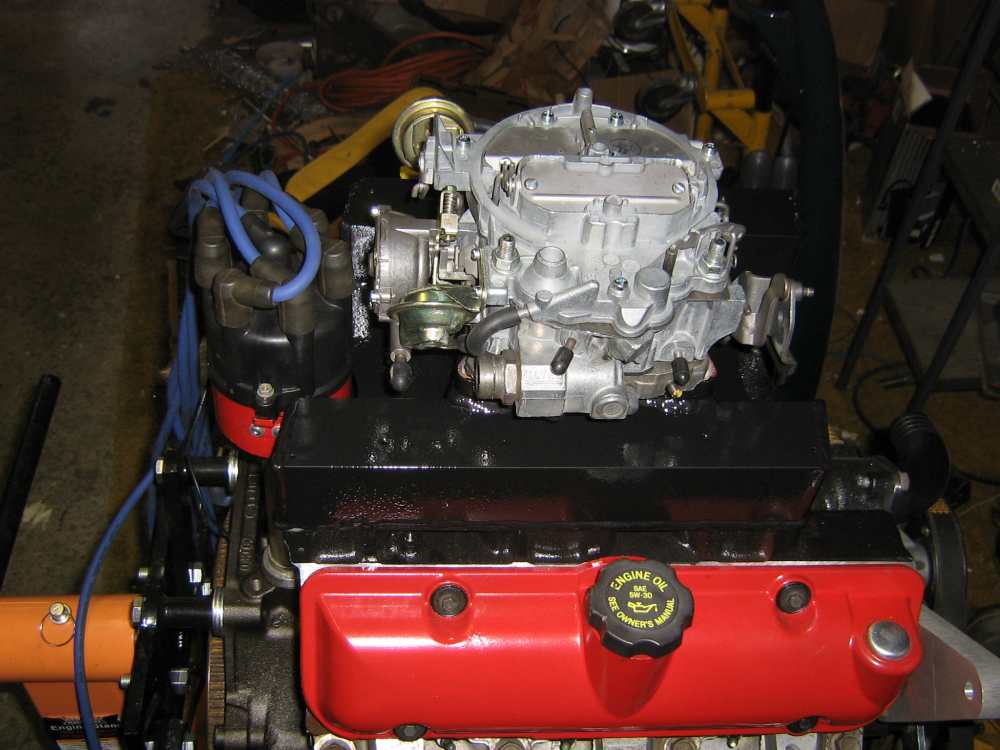

You've spent a lot of money already you might as well open the wallet wider. You need to have someone make you one of these. Good luck getting one made for under $1,000.

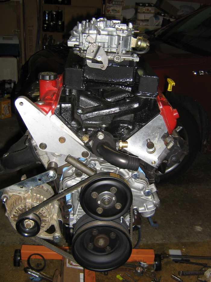

That is the one thing about a 60 degree engine that is not easy to over come. To bad that you can't get a victor intake for them. Back before they went FI you could get HIPO carb intakes for them. But that was a long time ago.
07:31 AM
olejoedad Member
Posts: 18167 From: Clarendon Twp., MI Registered: May 2004
Edelbrock still makes their Performer brand intake for 2bbl and 4bbl 2.8 V6.
