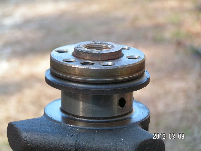

There is another thing to consider. Your engine’s crankshaft has a large bushing that uses it’s inside diameter to center the torque converter. The bushing for the Manual, is longer and uses it’s outside diameter to center the flywheel. I just built an 88 2.5 and used a crank out of an Automatic to be mated to an Isuzu 5-spd. The Manual flywheel fit the OD of the Automatic’s bushing, but it wasn’t long enough to hold the flywheel in place without the bolts installed. This may work for some folks, but the potential for a 20lb buzz saw to break loose, bounce off the pavement, and come up through the driver’s seat was my concern. As far as I know, these bushings are NLA.
A two jaw pilot bushing puller with a slide hammer removed the one from a used Manual crank with no problems. After breaking the puller, attempting to weld to the bushing, and packing it with grease to use a plunger/hydraulics, the Automatic bushing didn’t budge until it was internally threaded and a slide hammer used. A very cold bushing made the installation a breeze. I hope this helps.

My 3.4, the 2.8 I used for dressing out my 3.4 to an automatic, and the 2.5 Duke I rebuilt and used it with a 5 speed 4 cyl transmission were all without a pilot bearings. There was a thread somewhere here that deals with this. None of the three stick shift transmissions that came in the Fiero had a pilot bushing. The 125C has a 'snout' on the engine side of the converter that has to go into the center of the crankshaft. It will not fit if there is to much rust and or scale in where the converter 'snout' goes.
I am not familiar with any other bushing around the rear end of a Fiero crankshaft.

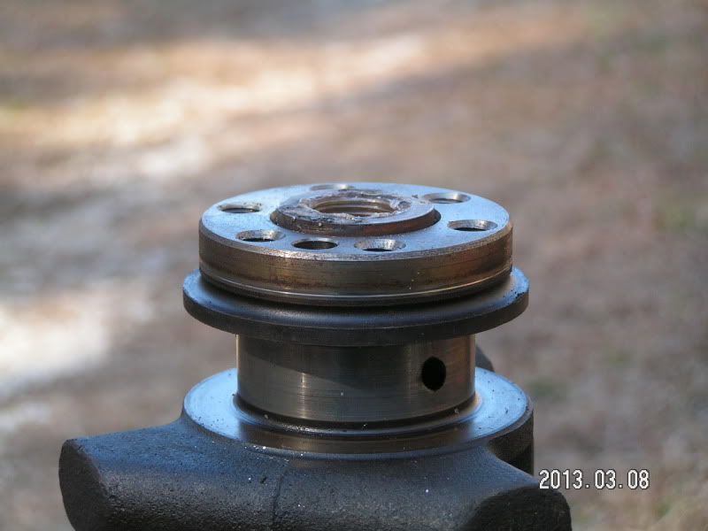

RedlinePlus
Posts: 101
From: Talladega Co, Alabama
Registered: Jul 2009
Report this Post03-08-2013 06:18 PM Click Here to See the Profile for RedlinePlusSend a Private Message to RedlinePlusDirect Link to This Post
A picture is worth a thousand words. This bushing looks pretty rough because it was welded on and threaded in the removal process.
This is what the crank from an 88 2.5 looks like with the bushing removed.
This is the same crank with a bushing for an automatic installed.
This is how the crank would appear with the bushing for the manual installed. The actual manual bushing has a larger ID.
Sorry about the confusion, I did not use the words “Pilot Bearing”. Hope this helps clear it up.

Report this Post03-08-2013 07:04 PM Click Here to See the Profile for RedlinePlusSend a Private Message to RedlinePlusDirect Link to This Post
RedlinePlus
101 posts
Member since Jul 2009
Hey, I was wrong, the Fiero store sells one.
http://www.fierostore.com/P...Browse.aspx?d=85&p=2
Hopefully to keep this thread from going bad on this topic, I would like to point out that this bushing has a large ID so it will not come in contact with the transaxle’s input shaft. It’s only purpose with the Manual transaxle is to center the flywheel. Hope this helps and doesn't cause any confusion.
