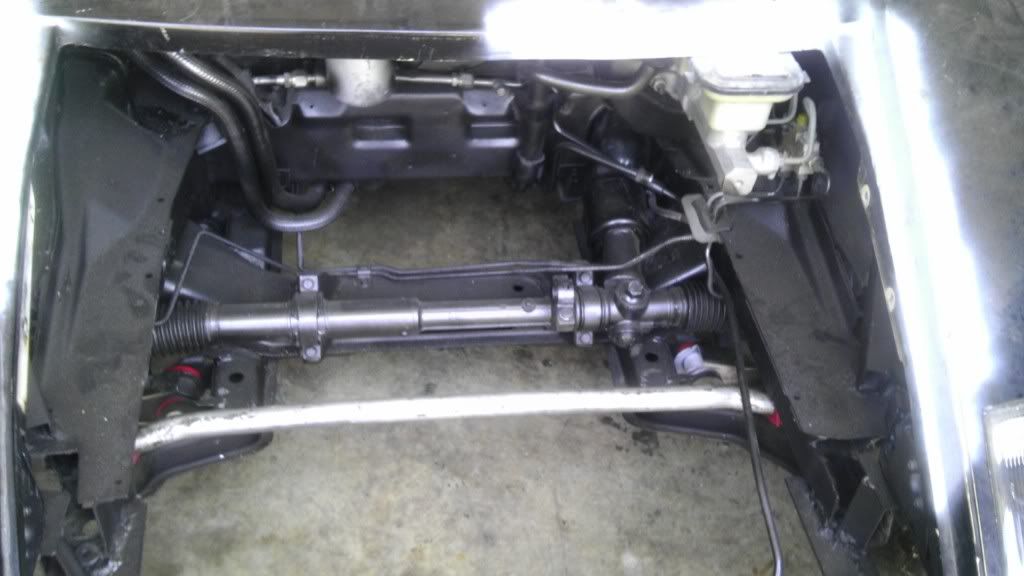

Hey guys can you anyone post pictures of how the condenser sits in the fiero. I am building a replica Lamborghini and it was out of the car when I got it. i just bought a condenser and don't know how it should sit or if I can have it standing up, laying down or side ways would it effect the condenser performance. below is how the front of my car look now.

The "World is your oyster" now, the mount framing is missing in that picture so it looks like you'll have to improvise in which case I'd look into the newer style universal parallel flow condensers that will give you more flexibility and efficiency with different sizes available. Ideally you'd want the condenser to stand straight up for a full frontal approach to in coming air.
