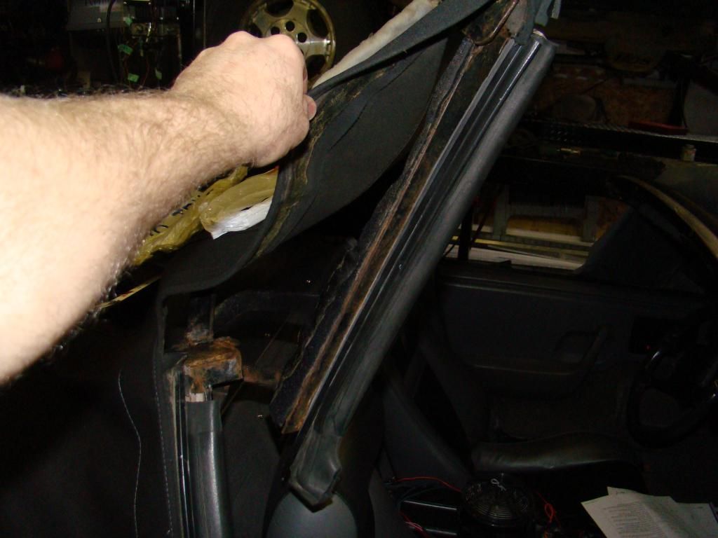

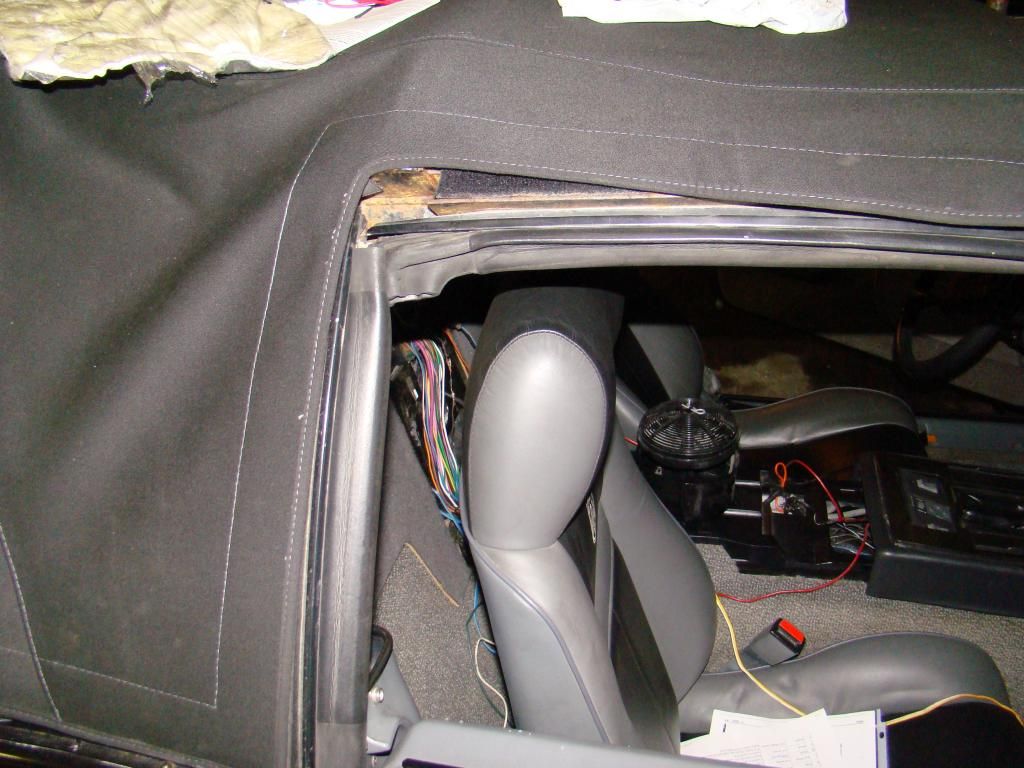

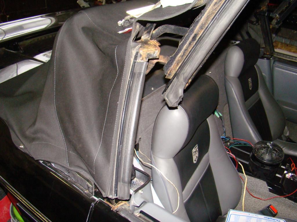

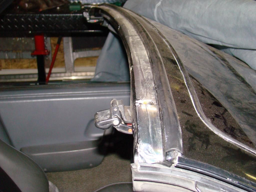

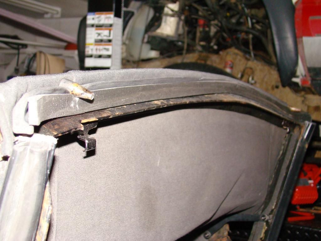

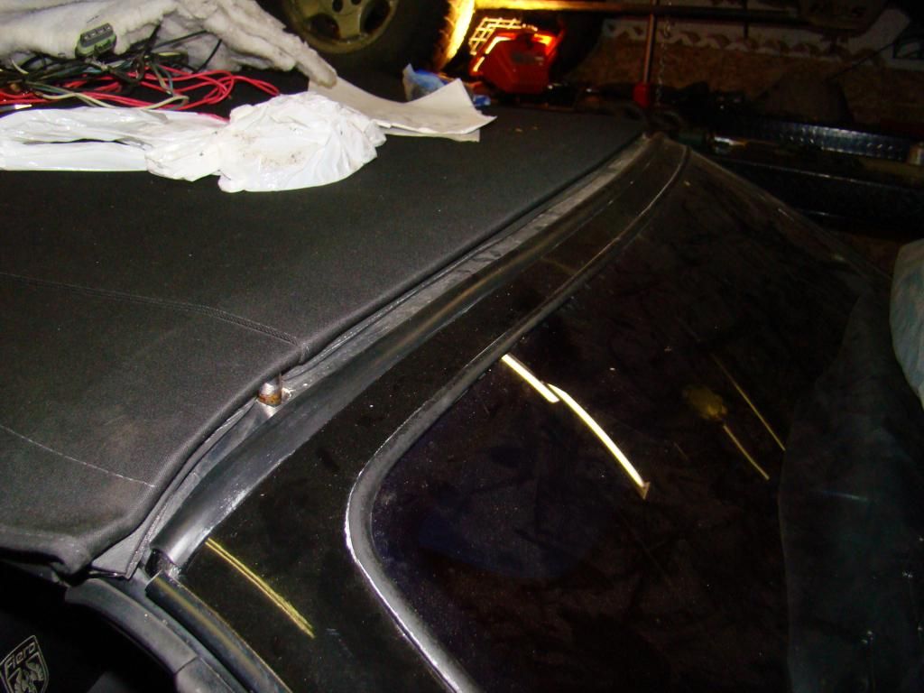

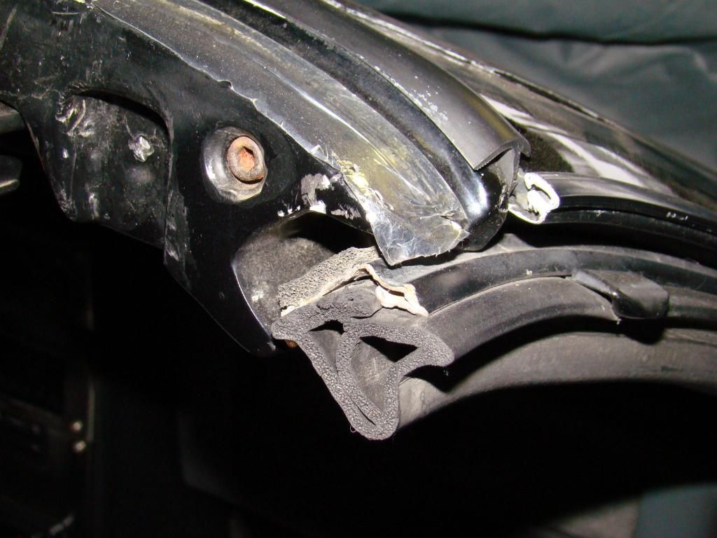

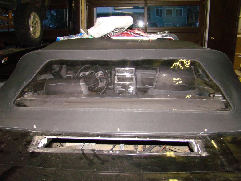

Here are some pics.

Where they cut the roof behind the windshield/above the A pillar, you need to either make a piece of rubber to make that corner finished on both sides or lay down a nice shaped amount of silicone sealer. That whole corner is going to allow a lot of water in. They just made 2 straight cuts in the rubber on there with nothing done for a corner. I have excellent luck making a corner just by putting some masking tape down where I want all the edges to be, squirt some good grade black silicone on the area and smooth it with your finger in one swipe and immediately pull of the tape. Let it set with the top off the frame at least over nite. Dont leave the tape on more than a minute or two after you apply the sealer and the edge will blend down perfectly.

yeah, that looks pretty rough. You may want to look at silicone patches for the holes, or even look at some convertible weatherstripping at the junkyard. Even a t-top weatherstripping may get you what you need (corners and such). They should have angled the cuts and sealed the ends. It can be sealed up, but it will take some trial/error. I would also look at covering the metal with something (more top material) that you contact cement on, for a more finished look. I had photos of my weatherstripping, but they are prints, not digital, and "somewhere" in my house. I will see if I can remember to dig those up. I had a different top, but it still may help you.

Yeah I gotta look at how other convertibles are done. I have contacted a upolsterer/fabricator about 6 hrs away and might bring them the car and see what they can do with the suspension, I would like to have it remade from aluminum for lightness if possible. I/m hoping to find a header seal from something compayible and that should seal up that part but its the back window part thats gonna be fun.
