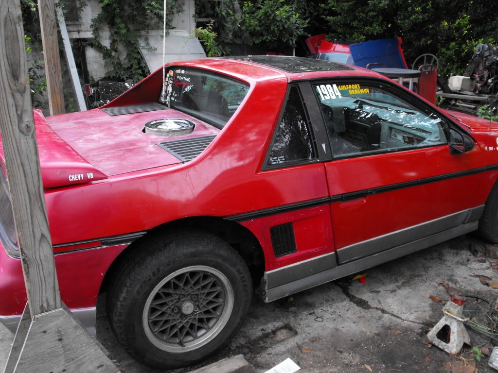

I made a little bracket that i pop riveted to the fire wall behind the driver. It was bent to clear the window. I had to notch the vent. I drilled 2 small holes in the rear edge of the roof so i could use a small wire tie as a strain relief.

My 84 used the drivers cover plate. It was my uncles car and he bought the car new and he installed a CB and used it to play hide and seek with his friends around town.

I have a 1/4 wave 2 meter antenna on an L bracket that I screwed to the front of my left side grille.
My brother has an HF screwdriver antenna mounted on a bracket attached to his grille with a ground wire to the shock tower/frame.
