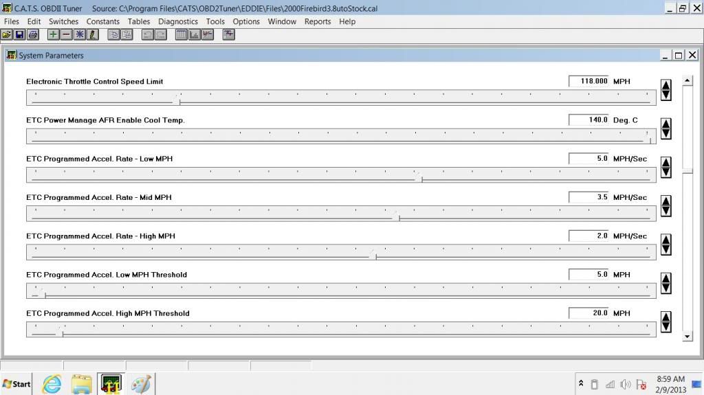

DefEddie
Posts: 1252
From: SALLISAW,OK
Registered: Jul 2009
Report this Post02-09-2013 06:55 AM Click Here to See the Profile for DefEddieSend a Private Message to DefEddieDirect Link to This Post
I didn't mean to imply that it was not a capable tool by any means.
Just that it is not complete.
I look at it similar to the way I see gun control and gov. deciding what we don't need.
hptuners decided that the other tables were not safe enough for people to have so they do not provide them.
In their case,it is their product and they can do as they please.
Dennis,i'm guessing you've not tuned an ETC car?
ETC have TM built into them,as well as tables controlling the ramp/opening rates of the blade.
Offhand I think an ETC 3800 table for a 2k camaro was limited to about a 6mph ramp rate in low,med and high speed chart.
I don't believe HP provides these,and is what I was thinking about.
[This message has been edited by DefEddie (edited 02-09-2013).]

I have TCII,TT as well as EfiLive commercial.
I've only somewhat looked at the TT but it looks like an excellent tool,Efilive I don't use except for a bidirectional scantool cause i'll be damned if i'm paying to program a vehicle after spending all that cash on the tool.
But it makes for an excellent *almost dealer quality scantool for diag purposes.
I flash everything with TCII,John is awesome and I've not had better support from a company ever.
I make sure and tell him I appreciate him in every email i've sent over the last several years.
darkhorizon
Posts: 12279
From: Flint Michigan
Registered: Jan 2006
Total ratings: 451
Report this Post02-10-2013 05:02 PM Click Here to See the Profile for darkhorizonSend a Private Message to darkhorizonDirect Link to This Post
Originally posted by DefEddie:
You worked on the V6 VDF's?
Then you likely have a few of my files onhand and I also owe you a big thank you
When John was developing support for them I was working at a dealer as well as doing tuning and problem solving work for local car lots.
They were more than happy to give me run of their lots and allow me to download .bin's of all the V6 cars which I then sent to John for development of the V6 VDF's.
So your work is much appreciated.
I have glanced at some TC2 VDF's but I have never had a reason to dig into anything... more is not really better in most cases, these stock ecus operate very simple.
