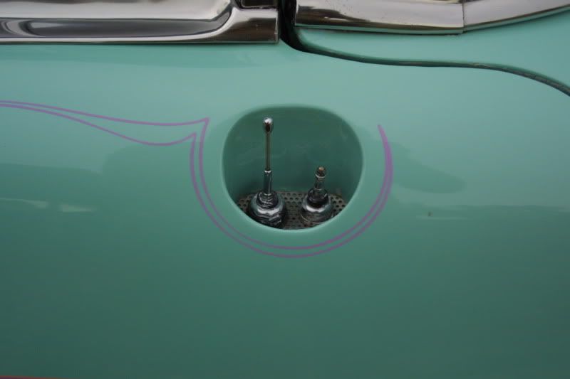

I think he is wanting to make something like this general shape (frenched antenna hole), but into the console:
If the area you want to do this in is covered with some type of vinyl then as Blooze said you probably won't be able to stretch it far enough. If it is just plastic, then you are probably better off drilling the hole, making a plug of the needed shape, slide it into the hole, then build up the console on the backside with epoxy/fiberglass or something, then once it is cured pull the plug out and clean/detail the well.

Thanks, Bloozberry, and fieroguru that is it on the money!
