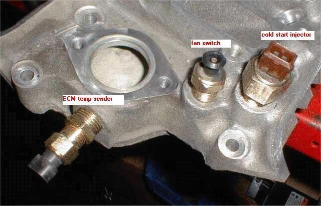

If you changed the CTS that is the wrong one. There is actually a Radiator fan switch.
If you ground the wire to the swich and the ran runs (key on of course) then you know the wiring is good and the swich has failed. (or unlikely lost it's ground through the manifold)

Changed that too, that's the single wire sensor on the topside of the engine. That was done.

Did you test the wire by grounding it? If you did and it did not run then you have a wiring or connector problem somewhere between the engine and the AC control head since the control is all on the same wire.
What did you use to seal the new switch?
