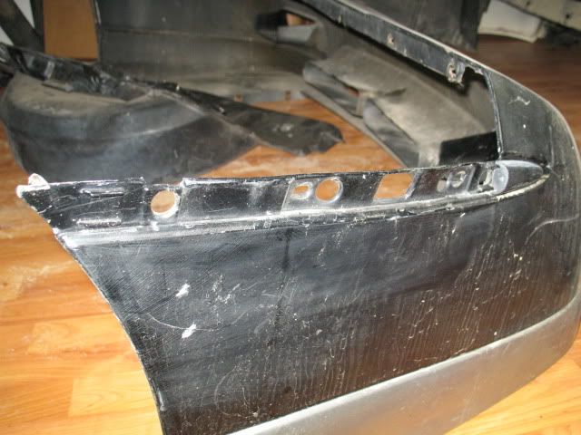

To convert the Ribbed Aero front fascia to Smooth, you just cut the ribbed molding portion off. The Smooth side marker lights cover the removed section.
Here is a Smooth molding Aero Fascia:
Here is a Ribbed molding Areo Fascia with the ribbed molding portion removed:
