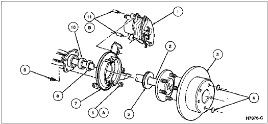

Remember. THERE is a difference between brake PADS and brake SHOES.
There are drum brakes inside the disks that is used for your E-brake, those can be adjusted. the pad adjustment it is done automatically.
I have never looked at a fiero rear e brake. but this is how most of them work
This pic is not for a fiero, but gives you the idea. The ebrake is # 7. and stops by rubbing the inside of the rotor # 3.

That's actually not how it works on the Fiero, the e-brake mechanism is built into the caliper, and on the 84-87 cars, might be one of the worst caliper designs of all time.

Originally posted by Puffpufpass:
I have never looked at a fiero rear e brake....
Quoted for truth. The information you posted would be correct for a Corvette, but it is totally wrong for a Fiero. FWIW, the system you describe (mini drum parking brake inside a hat-shaped rotor) was originally a Porsche patent; the 911 and 912 used it back in the 1960s.
