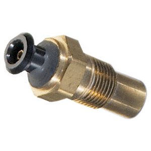

your fan switch probably isnt working, its located near the thermostat.
thats what it looks like
as for recalibrating. there is no recalibration, its based on resistance of the coolant temp sensor located on the rear bank head near the #6 cyl. there will be 2 green wires one is for the temp gauge and one is for the idiot light.
