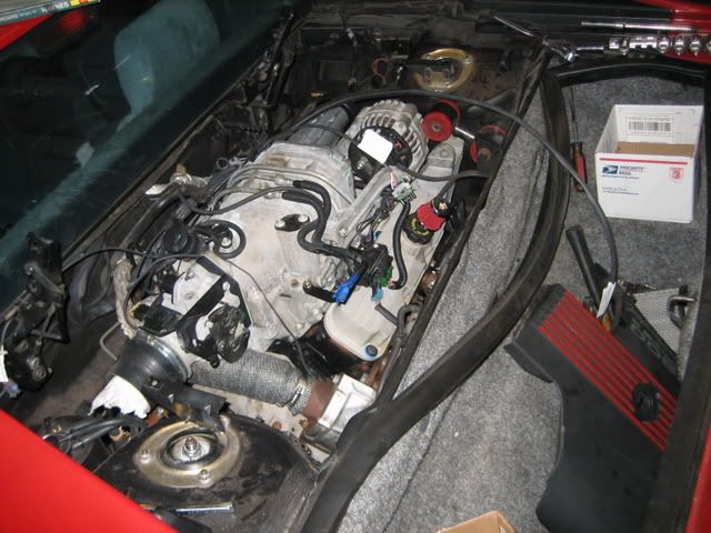

Hi, I want to get a breather for my 3800sc I just don't want to pay 40+ bucks, I saw a pic somewhere where somebody drilled out the oil fill cap, and put a small breather filter in it, anybody do this?
Like this?
I am not sure why, I cant remember, I didnt keep it that way...
