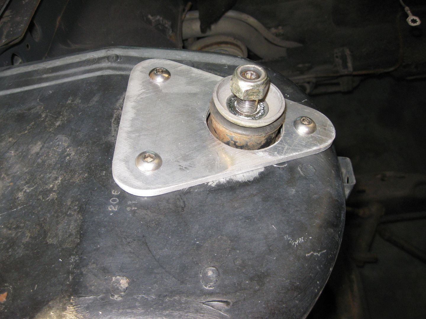

The only way you will have access to the camber adjustment bolts from above is if you drill a large access hole for them in the strut tower. Looks like a gimmick product without practical application to me.
If you want to increase the available camber adjustment, do something like this (88 fiero):
