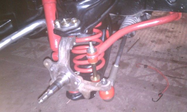

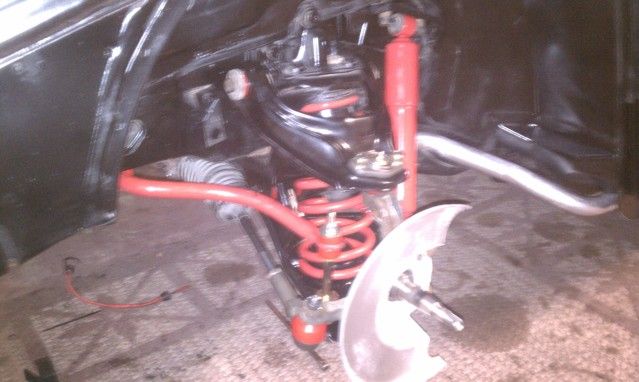

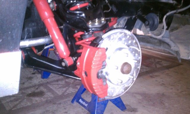

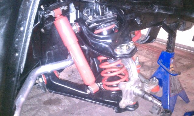

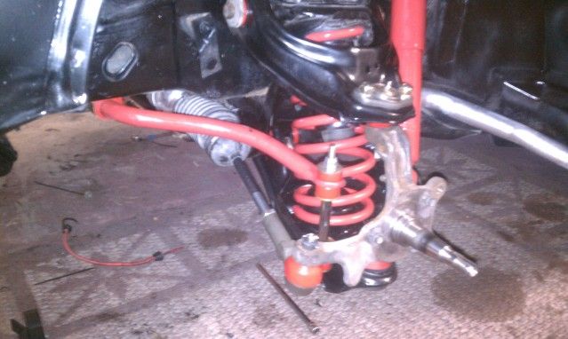

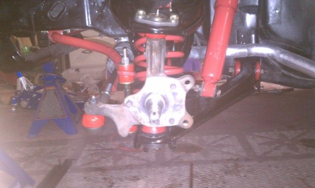

Any pics or diagrams? A buddy of mine is the one who took it apart. He didn't take pics, but it would help me if anyone here has a few they wouldn't mind sharing.

86GT

Thanks!!
