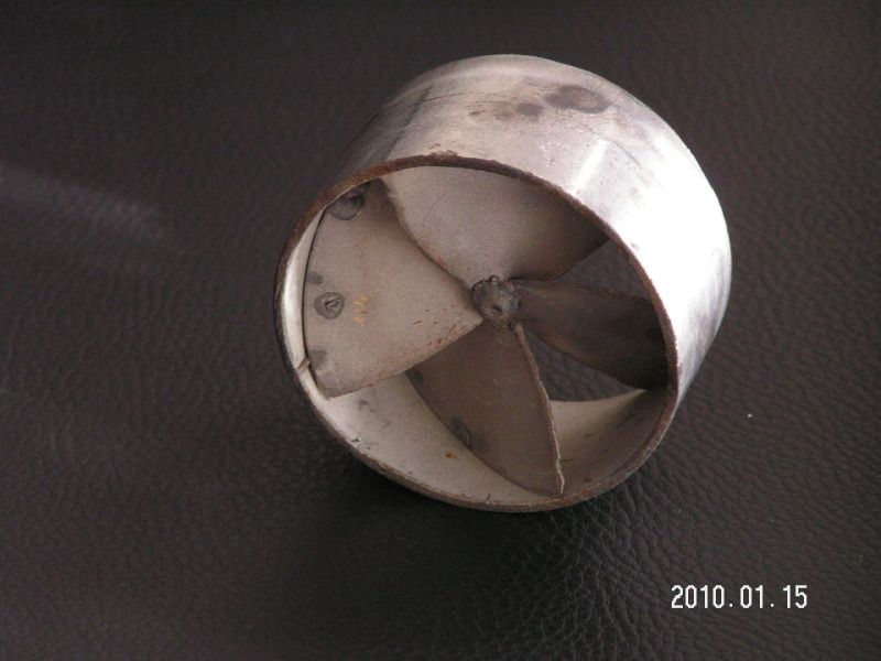

I made this 2.5” baffle and put it in the center of a swaged test pipe to lower the noise level coming from the walker turbo muffler on my 88 L4. Made a BIG difference. Didn’t see any drop in performance or MPG, but with a 4500 redline, you wouldn't expect any. Just another option if the dual outlet muffler on the 4 is to loud for your taste.

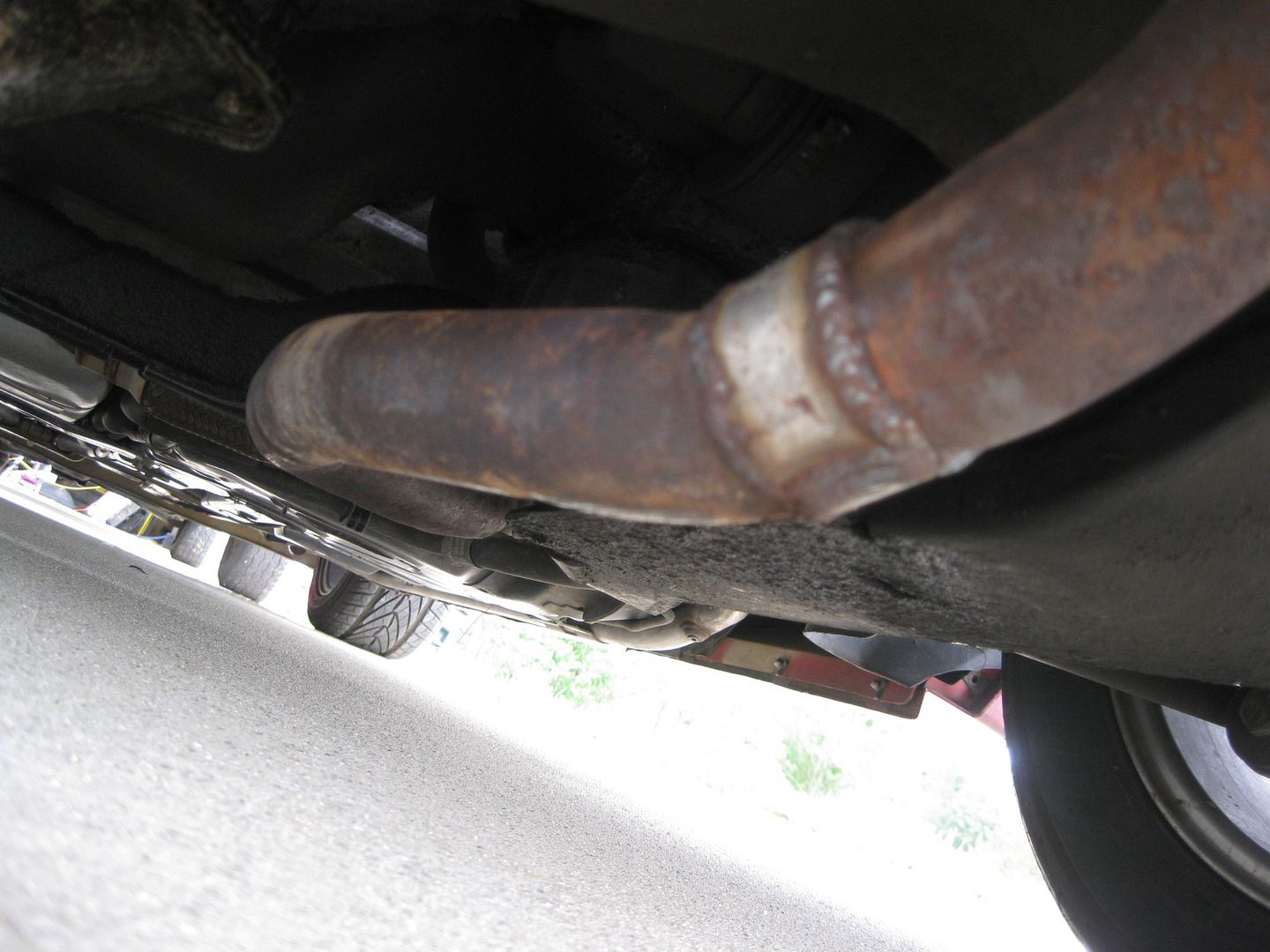

Here's a pic for you of my 88 2.5's exhaust. Ok, it's been modified to fit on my 4.9 but the PO said it was a Ocelot performance 4cyl exhaust he ordered in. I was running it on the fiero as I got it and it was pretty loud. When I pulled the engine I found a few of the exhaust manifold bolts loose in the head and that there were no bolts connecting it to the exhaust pipe! That explained the knock sound it would make under hard acceleration. If you check out my swap thread https://www.fiero.nl/forum/Forum2/HTML/122389.html you can see what's inside the muffler when I cut it open to change the intake tube from the small 4cyl tube for a 2.5"exhaust tube to handle the added 4.9 output. Just thought it might be of interest given your topic.
