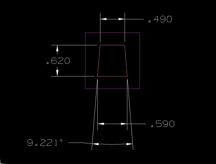

Does anyone know the specs on the taper for the rear tie rod ends for an 85 GT?
I'm trying to confirm the taper angle on the stock tie rod that threads through the tapered hole on the knuckle. I have found that GM makes two tapers: the common 1.5 inch per foot or a 7/8 degree taper. GM also makes a 2 inch per foot or a 9.5/10 degree tie rod taper.
I'm modifying the rear toe link mounts on an altered (Northstar engine) 85 cradle and plan to re-taper the mounting hole on the knuckle from the underside.
Anyone know this angle?

My son figured out the taper or angle on the tie rod end surface...I think. We think its a 9.5 degree. We want to find a way to confirm or double check it.
I think we will have to buy a ball joint taper reamer. They range from $80-$140...ouch! Just want to be correct before we buy one and ream the knuckle.
I guess we could avoid the whole thing by cutting the mount off, turn it upside down, and carefully weld it back on.

I dont think there is enough precision in those measurements to determine the taper angle. I got 4.61 degrees or .967 in per foot.
Also, 1.5in per foot is 7 and 1/8 degrees of taper, and 2 in per foor is 9.46 degrees.

Looks close enough to 9.5 degrees

You only solved for the angle on one side, you have to double 4.61* to get 9.22*. It must be a 9.5* taper

Yes, my son calculated it as a 9.5 degree taper or 2 inch per foot using both the knuckle mount and the tie rod mounting surface part of the stud. I'm amazed that this information was not found with GM or any of the tie rod brands and specs. At any rate, I will post the final result to document for anyone in the future that may need the info.
