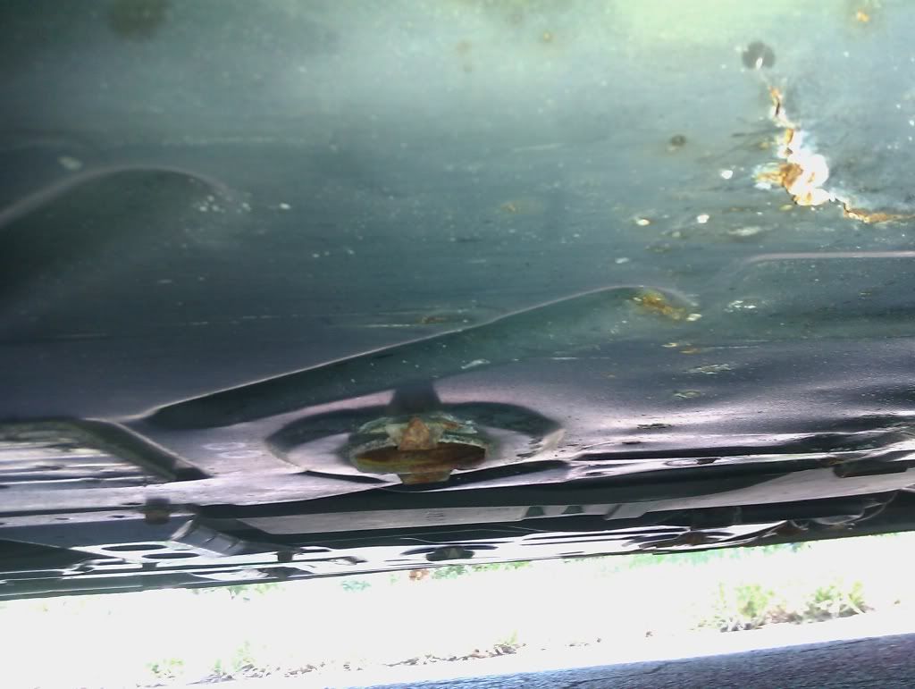

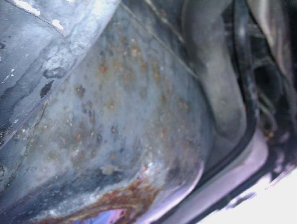

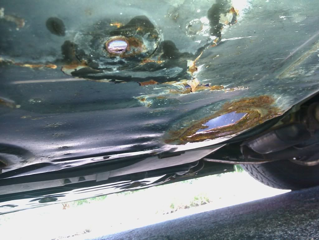

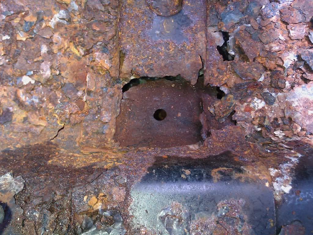

So I pulled the carpet out to inspect the damage..
Has not been cleaned up yet..
But any of yours worse than this?
rear driver side
front drivers side
the hole that was made from the rear left driverside seat rail
underneath rear drivers side
underneath front drivers side
underneath the back driverside wall
You think FieroFactory would have a floorboard or maybe even that cross rail for the seat?

I thought mine was bad; one of the big plugs is completely gone, and fairly rusted out around it.. But WOW that looks like you should have fallen out the bottom! Good luck! Wish I still had the parts car to chop up for ya...

Wow, that's a couple days project. Did this car come from Michigan?
Start stabbing the floor with a screwdriver, if it goes through, that section needs to be cut out. Then take a wire wheel on the end of a drill or grinder and start removing surface rust, until you find a good thick spot, the original thickness of the metal. Cut along there strategically to make a good spot to weld the patch panels in. Wire wheel the rest of the surface rust off, and POR15 liberally.

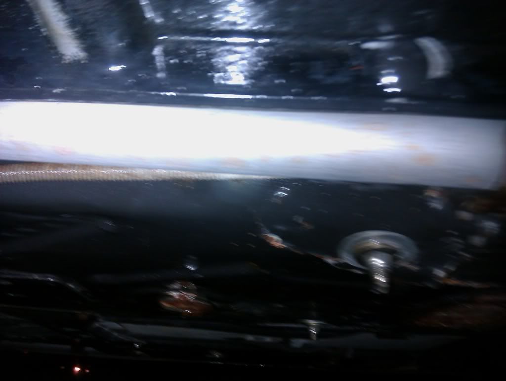

@riceburner98... Yea I was in my car at LA fitness gym parking lot about to drive home and heard something dripping underneath my car (it rained 15mins before) and when I took a look under my car I saw the first picture I posted earlier.. Not good at all.. and thanks for the thought tho..

When I posted the above, your pic and description did not do this job justice. It is way more than a patch. It is downright structural. I new welded floor is definitely the only way to go on this one, due to the structural integrity factor.
