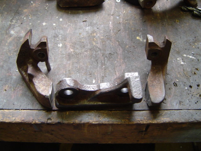

Since the Fiero brake calipers brackets bolted on from behind and the new caliper adapters bolt on from the front, I'm going to see if I can just mount the Fiero brackets to the back using longer bolts with nuts so they'll act as stops. I ended up having them powder coated with the rest of the suspension, so I might as well get some use out of 'em! I left them at home so I'll have to try next weekend, when I'll also have to replace my stripped outer tie-rods with Rodney's. More parts I should have just bought new in the first place..

https://www.fiero.nl/forum/Forum2/HTML/115704.html
I swear I looked through pages and pages of search results and didn't find that thread. I Googled "Fiero front brakes" looking for a good shot and one of the pictures was the Fiero brake bracket cut into pieces. Clicked on it, and brought me to the text version of that thread...... Yeesh.
Looks like another trip to Fastenal. I ordered the M12x1.5x40 bolts for the fronts, went to use them and they were M12x1.75. Brought them back and the guy said he'd never seen them labeled wrong like that before. Figures. We'll see if they can get the right 75mm bolts! Though I really Really REALLY don't want to take the calipers off again..

Excellent find!! I like this idea and the one Will posted in the linked thread.
Thanks for finding this.
I had the same situation with the Russel lines as you mentioned. Click on my 'Home' button, enter site and go to page 7, we had the same solution.
Kevin
Edit to add: I also like BrewCheese's idea on the replacement of the bolts in the link.

Finally ordered the bolts today.. Fastenal is pretty much the only place that seems to have them. $38 shipped, with 4 flange nuts to go with them. I didn't want to drill out the spindles and lose those threads; not sure I trust just nuts to hold that many parts together. Of course I ordered 60mm, and the post in that thread says you'll need 75mm. Hope I didn't measure wrong! 40mm bolts go through the Lebaron brackets, spacers and the spindle with a little to spare, 20mm more should be plenty to go through the stop bracket and pick up a nut on the back. I think.
FWIW, I got (4) 11114841 bolts, and (4) 0162312 nuts. Nuts are only 8.8, but they're really only holding the stops on. If I can break an 8.8 nut just with the steering stops, I'm doing something very wrong and probably won't survive it.
