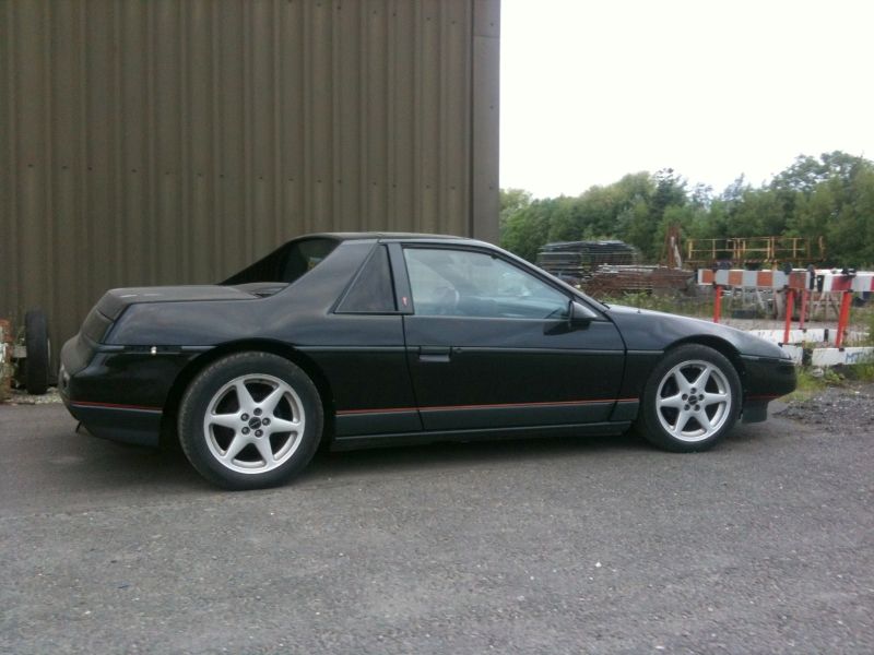

Are you keeping the coupe front fascia? Ive fitted FX's to my 87 coupe whilst keeping the coupe rockers, but widened and lengthened them as they're way to short and narrow to work with the FXs... I think it helps tie the 2 very different body styles together.
I'd get the rockers and door skin with its FXs on first, then check everything is level and that your panel gaps are good before you drill any holes. Then strike a level from the door FX's, There was definitely a certain amount of eyeballing involved, but seem to remember using the speed nut prongs on the back of the FXs as a centre punch to mark the areas to be drilled.
Have fun and post pics when its done!

Mandark
12 posts
Member since May 2008
Heres mine...
Still a WIP

Thanks for the comments. I figured a lot of it would be eyeballing and being careful. I suppose that if a piece turned out a bit off it could probably be redone as well (though that might be a pain).
And no, the coupe nose is being replaced by the aero front end. However, I have to say that the way yours turned out looks very nice!

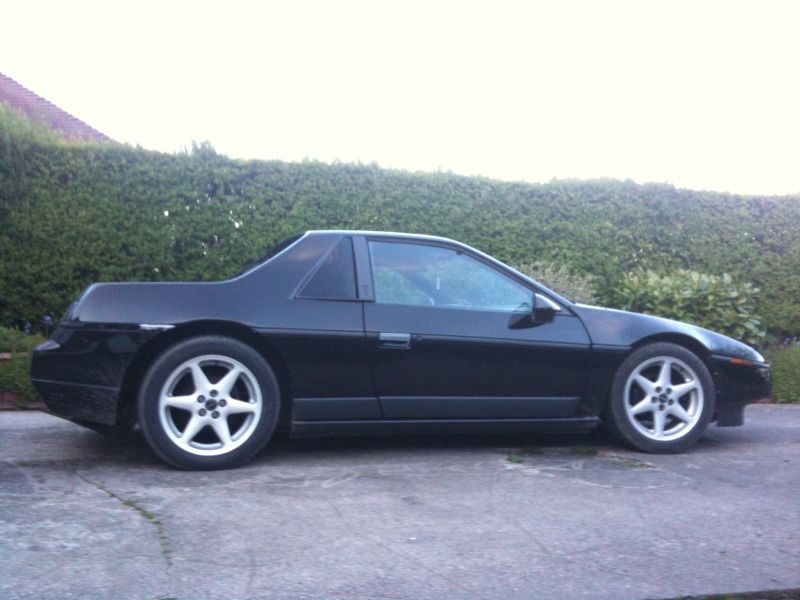

Originally posted by Mandark:
Heres mine...
Still a WIP
That looks pretty good!
Do you have another side shot where the rocker shows up a bit more. I'd like to photoshop the rocker (just the rocker, not the rest of the ground effects) the same color as the wheels and see what the car looks like.
Did a quick and dirty photoshop of what I had in mind. I"ve never liked black rockers as they often disappear into the shadows under a car and make the car therefore appear to have more (than desirable) ground clearance. All this notchie needs now are some five spoke mags.
The silver colored rockers remind me of the way Vettes were done years ago.
Heres mine...
Still a WIP

Originally posted by fieroall:
Wow I like this look a lot! Do you have a build thread with info on what is involved? Especially how you widened and lengthened the rockers?
Thanks
Cheers! I was intending to start a thread but never got round to it, I'll create one shorlty, took lots of pics of the rockers too.
Good work with the photoshop =) (I added the orange pinstripe in photoshop in the 1st pic) The rockers and effects were going to match the Borbets at one point. It was a little too close to white for my taste though. But looks good in your pic, i like the 'Vette reference, I always saw the Fiero as the Corvettes younger brother

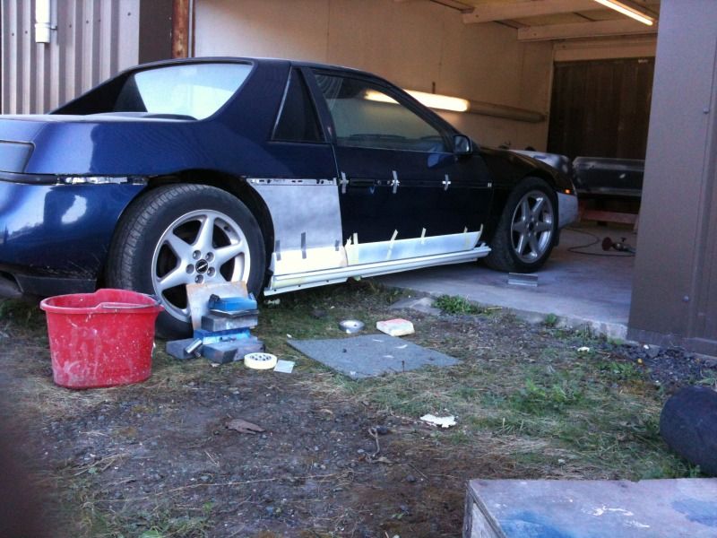

Here some early on pics.
The white is just primer here...
The coupe rockers roll under so the tend to aways be in the shadows, they're actually a matte gun metal silver.
