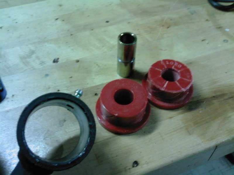

I made mine grease-able. I bought them from prothane, red. Poly grease is available in tubes, I have one to grease mine. Here: http://www.summitracing.com/parts/PTP-19-1751/ (I actually got it from a local race shop in Canada, but I'm pretty sure I used that part #)
Was it necessary to make them grease-able? I have no idea but I never have to worry about them squeaking.
If you want to make them grease-able you have to do a little work to do it correctly. I do have some pictures and info if anyone wants it. Basically the main part is you have to grove the metal pin that goes inside the bushings.
Also read ogre's cave, there's an article in there explaining why only part of the bushing should rotate.

Please do post some info and pics. I bought a full Prothane kit half a year ago and only got around to install the dogbone ones. Probably gonna do it all this summer.

This is an excerpt from another post I made "I see you already have the poly in, but I glued the front bushings in. The rears where tight enough for me but I found the fronts where able spin too easily. At the very least, don't grease between the bushing and the metal sleeve. I also sand basted the outside of the poly bushings to give them a rough finish, so they would have a grip better on the metal sleeve. The reasons behind all that is in the ogre cave.
I also installed grease fittings so that I could easily add grease to the bushings when ever I needed to. The way I did it was, find a good angle and space for the grease fitting on the metal sleeve. With the metal bushing installed into the poly, I drilled down and made a dimple in the metal bushing and then I marked each bushings location.( I gave each bushing a number, as you can see the scribed 12) I then made a grove about the width of the grease fitting in the metal bushing in the middle of where the dimple was made. The grove is so that the grease gets all the way around. It works really well."
"For the grease fittings, I did them after mine were powered coated. Drilling the hole is pretty easy, just center punch first. And make sure you put them in a way that you can get to them when they are installed on the car. The part that needs to be done is the grooving of the metal bushing, if that isn't done then its pretty much a waste of time. I did mine on a lathe, obviously the easiest way but if you can't get to a lathe there are a few other ways to do it. A pic of my metal bushings grooved is bellow."
There is already "horizontal" groves in the poly itself. The grove cut into the metal bushing allows the grease to go down all of the groves. I didn't have a pic of the groves in the poly so I borrowed one. Don't have pics of the grease fittings in the control arms but there's not really much to see there.
Clear as mud?
