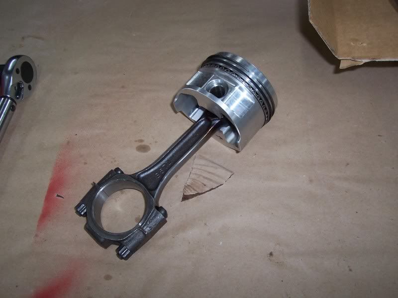

I went with Ross Pistons when I did my rebuild and ARI for my rods... it's a 3.4L p/r though... Both companies make anything you give them

lou_dias

Originally posted by unboundmo:
Are you sure Raydar...? I know you've been around but GM spending money for forged?
Are your pistons dished like in the pics? What is your compression ratio?
unboundmo
Posts: 2242
From: California
Registered: Sep 2006
Report this Post04-09-2012 09:51 AM Click Here to See the Profile for unboundmoSend a Private Message to unboundmoDirect Link to This Post
Those are my pistons... With those rods I get a compression ratio of 9.25:1
