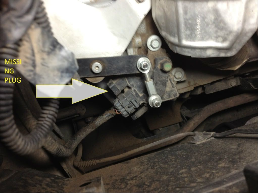

There is nothing plugged into the tranny here:

Since your trans is 2003 you dont need that connector on the trans, they arein the round trans plug on some newer models.

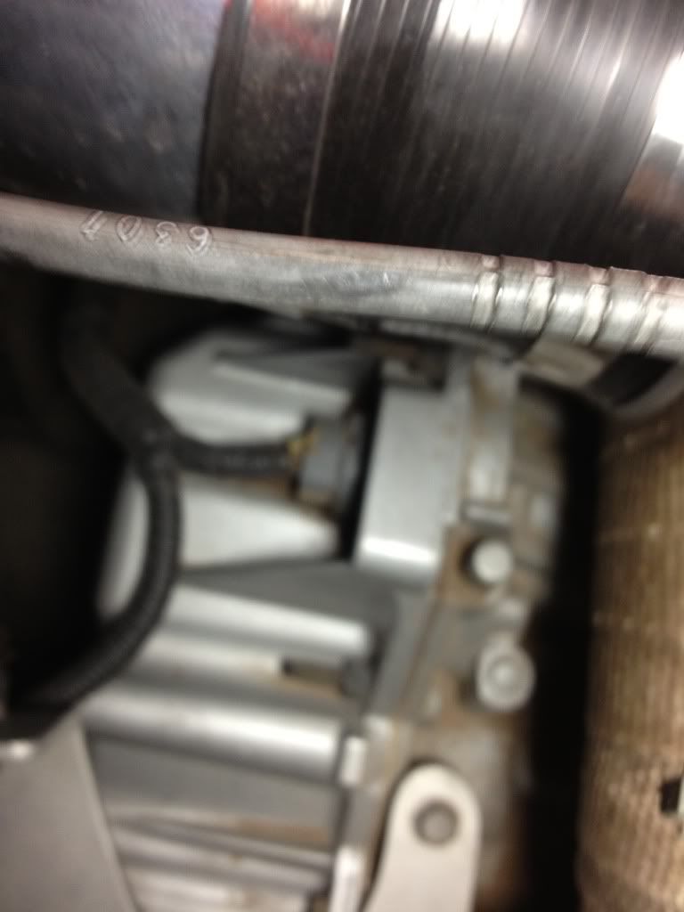

This one on top of the trans??

Yes, Those Transmissions usually dont have the range switch at all, but one has to be added in the Fiero for the neutral safety and reverse lights.
