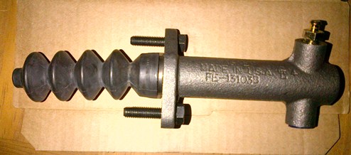

I have recently purchased an '85 GT 2.8L. The previous owner gave me a box that contained a slave cylinder. It doesn't have the push rod. If I'm going to replace the slave, is it possible to get a new rod? I'm guessing reusing the one on the car is not a good idea. I'm also not 100% sure I have the right part. Any help?

If you have the original one there would be no problem with reusing it.
It should be around 5 1/2 " as I recall. I misplaced mine for a while and used a 2.8 valve pushrod and it also worked just fine also.

It's a 4 speed, and currently the clutch will not disengage at all. The previous owner thought it needed a new clutch, but after speaking to a couple of folks, I'm hoping it might just be a problem with the hydraulics, so I'm going to bleed them this weekend, but thought if I have the slave it might be a good idea to replace it. There's only about 1/2" motion on the slave, and I've been told it should be a full inch. The one thing that worries me is the shift doesn't feel quite right, I can't even find reverse

You are correct that you should get at least 1” travel out of the slave cylinder. If not make sure you bleed the system. Here is the factory procedure;

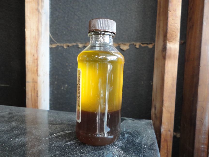

Well I tried to bleed the clutch lines, and I think I made it worse. The pedal is even spongier than before. I got a 'one man brake bleeding kit' and tried to get all the air out, but the bubbles kept on coming. Also, what was coming out didn't look healthy at all. Any suggestions?

Raise the front of the car as high as you can and gravity bleed it. I have always had best luck with gravity bleeding them, poor luck with other methods. If you used suction you likely drew air in backwads past the seals.
Bleed it a lot, that fluid is icky.

Yeah, that fluid is toast. I would put through at least a pint of new fluid before I tried to bleed it. Then use Archie's procedure (steps 14 and on are critical!):

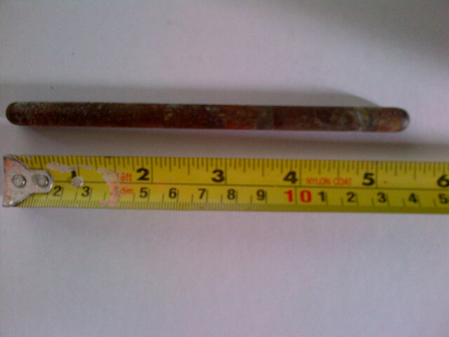

Report this Post08-28-2012 09:14 AM Click Here to See the Profile for NetCamClick Here to visit NetCam's HomePageSend a Private Message to NetCamDirect Link to This Post
Here's the old pushrod from mine - 5.5". If you weren't so far away I'd just drop it in the mail, but it would be quicker to get something locally.
