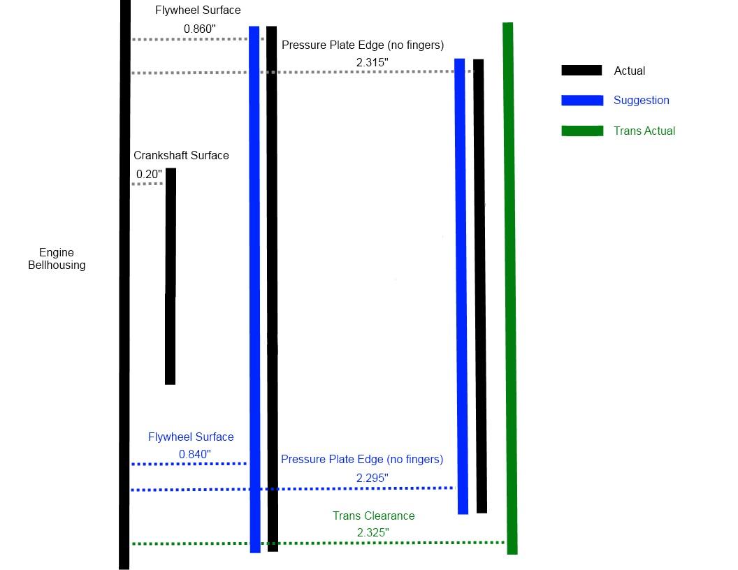

That's the problem - I don't know what caused the failure. I've since decided to rid myself of the stock fiero slave and go with the internal slave from the later getrag models. All I know about the failure is that my clutch arm swung freely about 4" with no resistance. When I got the trans off the engine, the TO bearing was still on the forks and the fork shaft seemed to be in perfect working order. This suggests that the clutch setup was wrong/bad/broken somehow. The problem is that I can't confirm where the in the clutch/pressure plate the failure occured. I want to believe that I overextended the pressure plate fingers and somehow bent them back far enough for me to no longer get good throw, but I still have no way to confirm this.
I decided to rid myself of the custom made flywheel and buy the custom application flywheel from SPEC for the 3800/fiero. I had to put it in the oven for 30 minutes @ 300 degrees just so I could torque down the bolts and get it flush with the crankshaft. I hope I don't ever have to take it off because it's going to require a large hammer.
Right now I have the problem of clearance between the hydraulic TO bearing and the pressure plate fingers. The measurements on my setup now are:
.835" - engine housing to flywheel clutch surface
2.45" - engine housing to pressure plate exterior surface (pressure plate fingers recessed 0.10")
2.23" - HTOB to trans housing
This alone means I'm 0.10" in the red (contact with the fingers at rest). I need at least 1/16" to 1/8" gap between the HTOB and the pressure plate fingers to allow for clutch wear. Which means I need at least 0.1625" to 0.225" to make up somewhere. I'll try to post some pictures once I get things figured out.
BTW, I'm starting to cool down from my whine-session last night. As you can tell, it was really late when I posted that and I was so looking forward to Carlisle that I was just ticked off and tired of feeling pressure to get things done in such a short amount of time. Once I decide to cancel a show (it does happen this often), I usually feel better because I'm not worrying all the time about getting things done in an impossible time table.

Wow, it has been a long time. I got a replacement pressure plate from Clutchnet after I dropped the engine and tore everything apart. I've been too busy the last few months to work on it - plus, I have been debating on whether to use the new pressure plate / clutch or go back to the Mcleod one I was using when this whole thing started.
The Mcleod clutch/pressure plate chattered some and I think that ultimately led to a failure in my custom bracket for the slave cylinder. Now that I have an internal TOB, I'm thinking I should go back to the more heavy-duty setup because I know it will hold. I don't think the Mcleod was damaged, and if I decide to re-install it I will take it to a local machine shop to have the pressure plate tested.
The Clutchnet seems to be a nice setup, but I'm still not sure the new pressure plate will hold the power. I do not want to have to tear this thing apart because the clutch slips. I've had bad luck getting this thing ready for shows and I want to make it to Carlisle this year.
Right now, the car sits in my garage waiting for me to put the clutch/trans back together. I'm also debating repainting the SC again as the last paint job is starting to bubble in places. I realized that the guy I paid to paint the supercharger only stripped the existing paint off and I believe if I were to get it media blasted the paint would adhere much better. The nice thing is that I can put everything back together and decide what to do with the SC after I make my decision on the clutch. I'm hoping to have some more updates after my upcoming trip to Australia in February. I expect to get some good progress made in March.

Ok, I finally have a small update (of sorts). I finally decided to use the McLeod clutch again - mostly because the pressure plate has a smaller profile than that of the Clutchnet, but also because I know it will hold the power of the engine. Unfortunately, when I went to place the McLeod disk against the Spec Aluminum flywheel, it was too large for the contact inlay they provide. This means I need to go back to the old steel flywheel if I'm going to use the McLeod.
The problem with the old steel flywheel is that it is 0.840" thick from crankshaft to flywheel surface where the Spec was 0.820". Below is a chart I made up showing the tolerances with the new FWD trans. I believe at best I should shave off 0.020" from the steel flywheel to get some "comfort" room between the pressure plate and the inside of the trans. The blue lines represent the future measurements with 0.020" taken off the flywheel. I welcome thoughts, I plan on taking the flywheel to the machine shop Tuesday.
Edit: I'm not much concerned about the TO bearing as I believe it can compress down nearly another .100" behind the highest part of the trans housing.
[This message has been edited by grsychckn (edited 02-21-2010).]

Report this Post02-22-2010 07:34 PM Click Here to See the Profile for grsychcknSend a Private Message to grsychcknDirect Link to This Post
Bump - taking it to the machine shop to grind it down to 0.820" deep on the flywheel. I guess I'll also have to get them to balance it again.

If it was mine, I would have them resurface it down the .020" and be done.
As for the balancing, was it balanced by holes on the flywheel face (and not the back side)? I prefer for the balancing to be on the back side so you do not have to rebalance it with every flywheel resurface.
grsychckn
Posts: 645
From: Stafford, VA, USA
Report this Post02-22-2010 08:41 PM Click Here to See the Profile for grsychcknSend a Private Message to grsychcknDirect Link to This Post
Correct, I don't know what I was thinking. So long as they take the same amount of metal off the face, it should still be balanced - duh...thanks for setting me straight.
