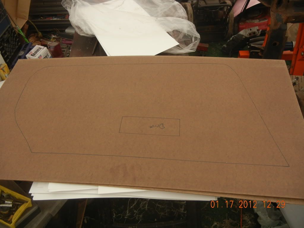

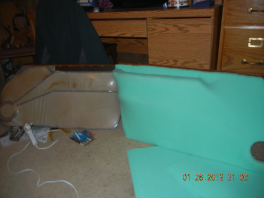

I just did some like this recently. Used the top part of the original door panel until the recess and used lewan for the rest. I added a speaker pod to it using wooden dowels 2 inches long and shaped my pull handle out of mdf. Covered everything in fleece, fiberglassed then covered in foam. I still need to cover them in vinyl. Pics below.

BTW, that press board that HCM2011 used is a PITA to staple into. Not to mention if it gets wet, it expands and gets soggy... I would treat it with some sort of water-proofing...
You're right it was very hard to staple. I ended up using a industrial stapler then hot gluing everything. Coated everything in resin so I'm not worried about them getting soggy.
