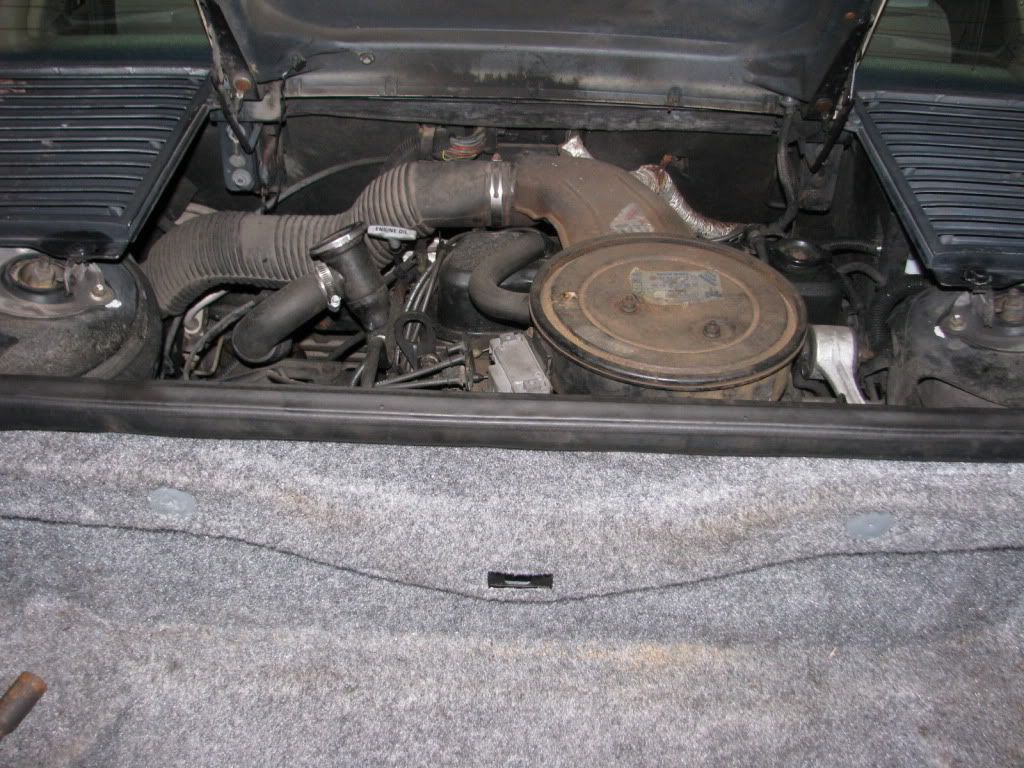

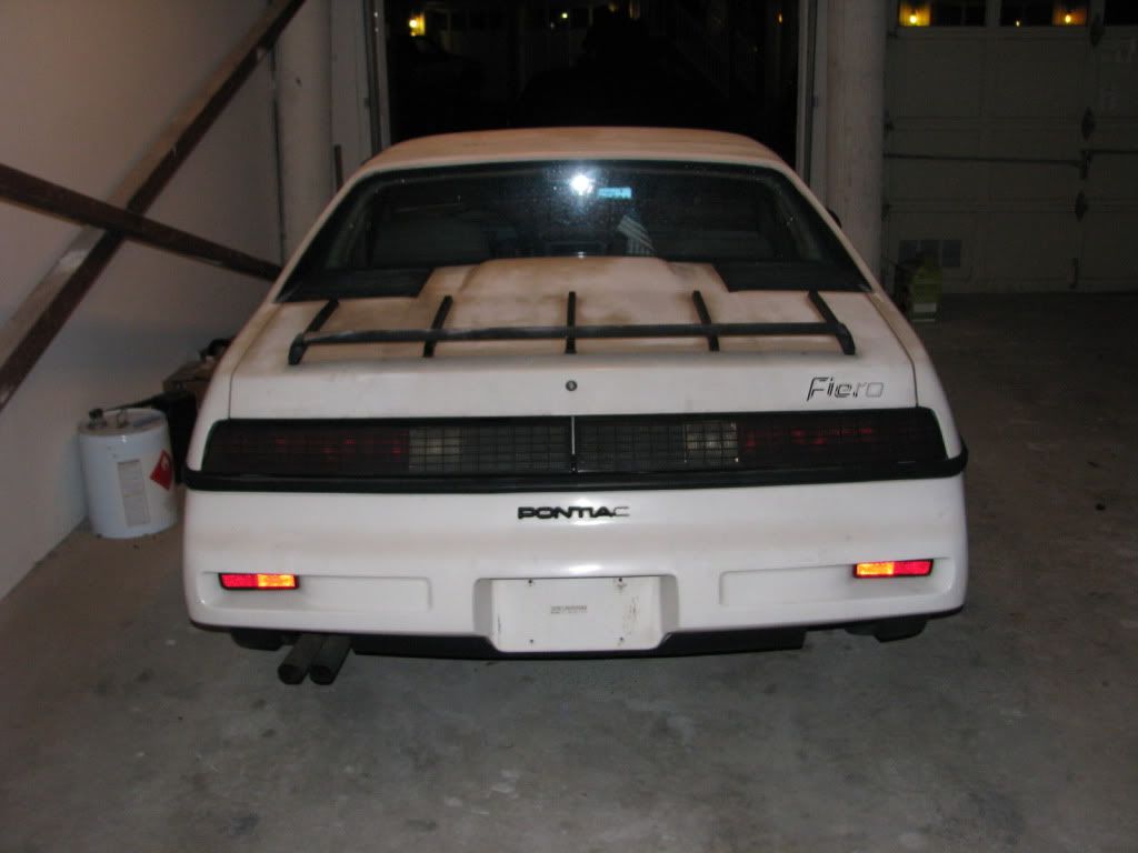

Still working some small bugs out of this car. Considering it didn't run and was rotting at the PO's shop I think she has come a long way. This is probably not a big deal but it kind of annoys me. 88 Iron Duke auto. When stopped and in gear/drive my idle speed is right on 500 RPM. Seems low to to me. It is a nice smooth solid idle butjust low. I can hardly tell the motor is running. Every other FIero I have owned had/has a Duke in it. And every one idled at 800-1000 RPM in gear at a stop. Is there any way to bump it up some?
This little car went from this
To this.
