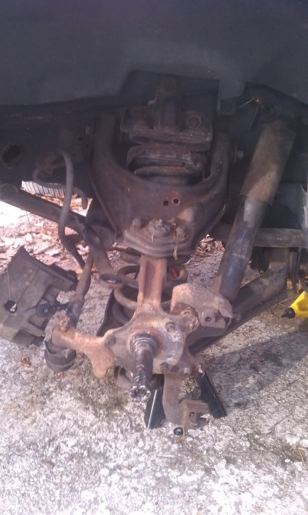

The suspension on my 1986 GT was in a pretty rough shape. I’ll describe the entire rebuild in another thread when I’m done with it, but in addition to the performance it had (or didn’t have), it also looked like crap. Nothing makes a car look better than a new coat of paint, so that’s what I did. I wanted something that would keep the rust at bay that had started to form on some of the components, AND something that would look good. I didn’t want it black either. I’ve never understood why people try to hide all that stuff by painting it black…let it be seen!

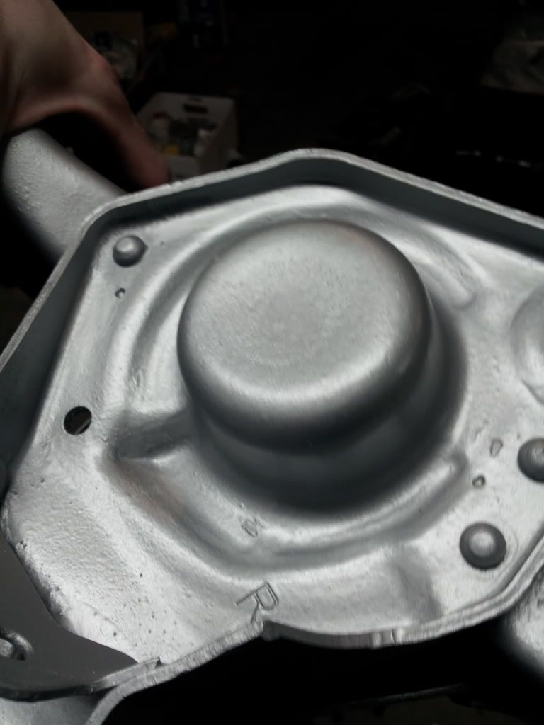

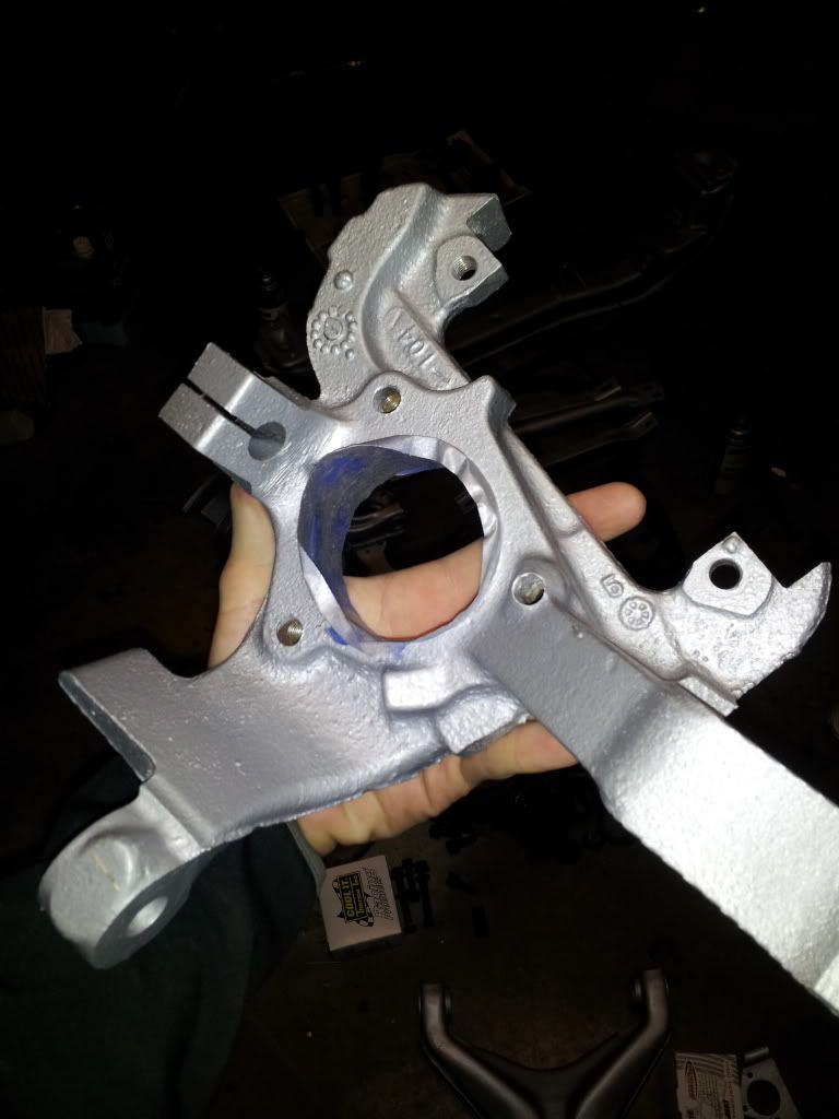

Here it is after the first coat. It looks great, but it did NOT flow through the HVLP gun for crap. It spit and sputtered like a spray paint can when it’s almost run out. Any idea how hard it is to make a smooth coat with a spray gun that is inconsistent? It’s impossible. It’s like trying to write with an ink pen that skips. You keep going over and over the same spot, but it never comes out right. The good news is, that the Rust Bullet coating never ran, no matter how heavily I hit a spot. It was really amazing actually.
The parts looks great. Unfortunately, I was only able to give it 1 coat, and the instructions specifically say it needs 2. Since my gun kept skipping, I had to make it super heavy in some spots just so it would cover everything. My hope is that one super heavy coat is almost as good as 2 lighter coats, but I guess we’ll see.
Finally, with what little paint I had left, I went back with a foam brush and hit any spots that I missed. You can sort of see the finish difference between the brush strokes and the spray pattern, but it’s slight.
